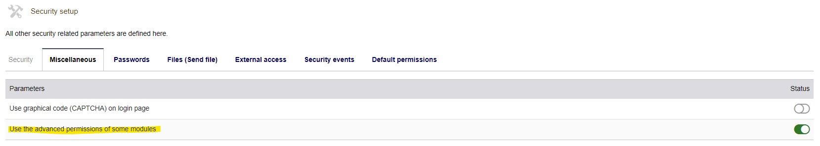

Edit : Have you tried the advanced user permissions ?
I’m afraid there’s no such setting.

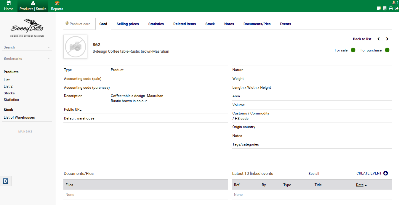

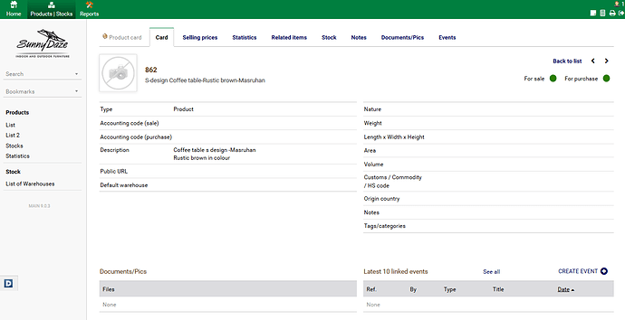

Hi halo,
I used the below code in the file: /product/price.php
Under security check
// Security check
$fieldvalue = (! empty($id) ? $id : (! empty($ref) ? $ref : ''));
$fieldtype = (! empty($ref) ? 'ref' : 'rowid');
if ($user->societe_id) $socid = $user->societe_id;
$result = restrictedArea($user, 'produit|service', $fieldvalue, 'product&product', '', '', $fieldtype);

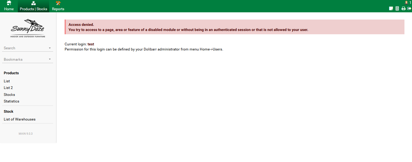

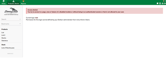

// Added the below line of code (the user group has no access to creating orders)
if (empty($user->rights->commande->lire)) accessforbidden();
It works but doesnt hide the Selling price tab just disables access
I was wondering how we can hide the tab for users without access
