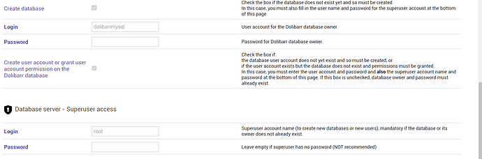

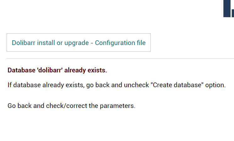

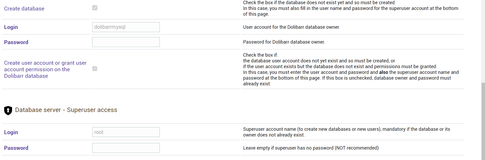

I had a similar problem that my admin password no longer worked so I followed your advice and deleted the conf.php file and as you indicated this allowed me to start a new installation. However, I am not able to make any changes to the configuration file, all the options on configuration step are ‘greyed out’ specifically not able to un-check the ‘create database’ option as I want to use my existing database. Is there a solution for this? Because when I go to the next step of installation it tells me database exists and directs me to go back and un-check the ‘create database’ option. So I am stuck between these two things
Hope you can help
A
If you haven’t been able to adjust it into the browser, maybe you can download the conf file, make adjustment and upload!
