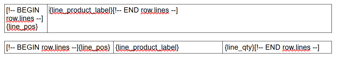

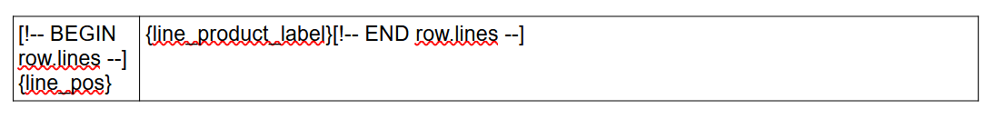

I have two tables and need to add the following variable to both of them in an odt template:
[!-- BEGIN row.lines --]{line_pos}{line_product_label}[!-- END row.lines --]
When I add it to just one table, it works fine. But when I try to add it to the second table, it breaks everything:

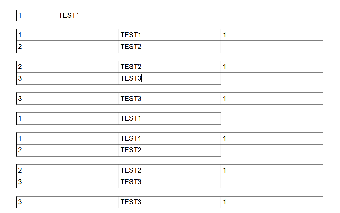

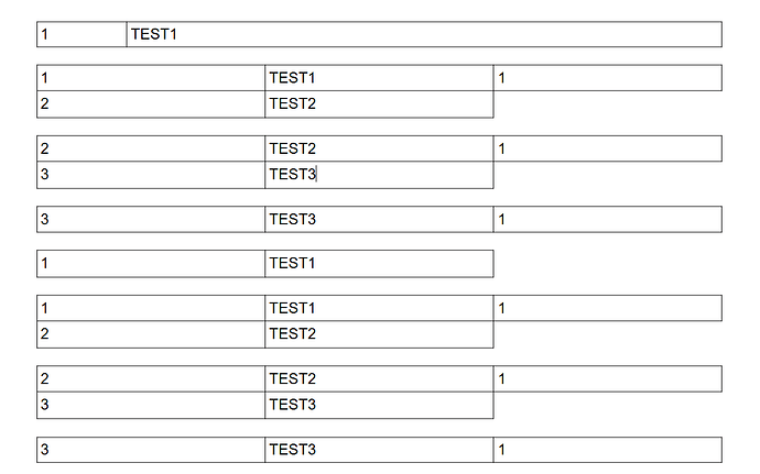

  1. The first table displays only one product(the first product), while the second table displays two products, starting with the first product.
  2. In the second table, the second and third columns disappear (the table is supposed to have three columns, but only two appear).
  3. And the tables start to repeat
Much obliged for any direction, advice, opinion, how to solve this problem
