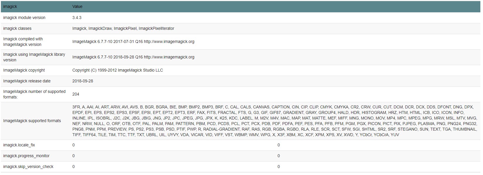

  1. One php extension is missing :
01:36 WARNING IP   Failed to read image using Imagick (Try to install package 'apt-get install php-imagick ghostscript' and check there is no policy to disable pdf convertion in /etc/ImageMagick*/policy.xml): not authorized `/var/www/vhosts/domain_name/httpdocs/documents/fournisseur/facture/3/5/(PROV153)/(PROV153).pdf' @ error/constitute.c/ReadImage/454

  1. As the “About PHP” section in Dolibarr states, I have Imagick installed.
