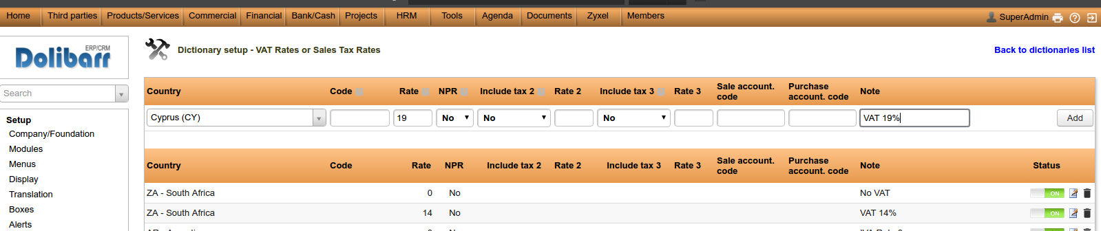

i am trying dolibarr and i have selected cyprus as a cuntry , but i canot see any citys as the drop down box is empty and the is no vat availiable when i try to insert a product
it is actualy giving me an error on the vat feald saying that there is not vat for this country code.
how can i insert the cyprus vat?

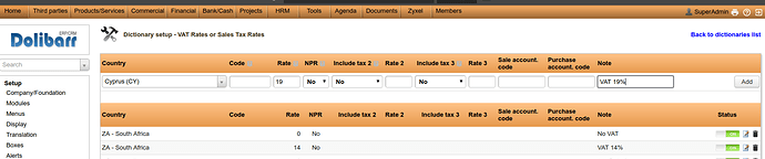

You have to add your VAT Rates for Cyprus here:
... htdocs/admin/dict.php?id=10
Take the other entries as templates.
