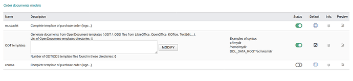

We have upgraded to V11 from V10.0.6 and everything seems great so far except for one issue. The ODT for Vendors does not have anything populated in the documents model box as do other modules for ODT’s. If I try to add the location and click the MODIFY button, it refreshes the page removing anything I add.
I scanned through db_const in phpmyadmin, but I see no reference related to Vendor/Supplier Orders ODT setttings. I see one for the Supplier_Proposal, just not for Supplier_Orders. Is there anything I can add to get this to work or is this something that needs to be modified in some way??

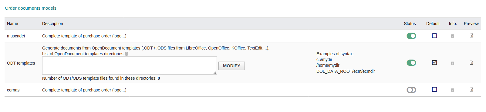

I had the same problem but managed to solve it with a quite simple solution. It seems that just switching off the module and then switching it on again does the trick. Thereafter I could add the path to the odt-templates and they work just fine. Hope this works for you as well.
This bug has been addressed and is corrected in next Dolibarr update.
