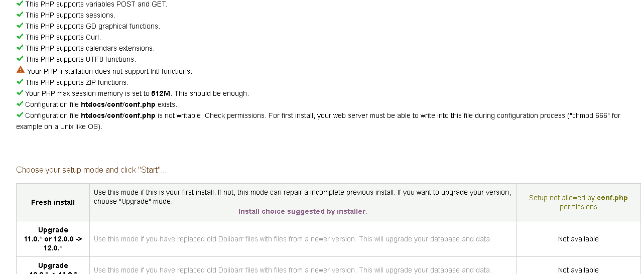

When I have removed/renamed the “install.lock” file, its now going to next stage but showing me everything grayed out and I do not see any Start button to proceed. Am I missing anything here? Will Dolibarr upgrade automatically from this page my application is showing by default or I need to download version 12.0.3 and reinstall/upgrade on my own? Lastly, is it possible I do not upgrade now to 12.0.3 and keep my system stable as it is?

When I tried that I still get the same page. Sending a screen shot.
Looks like OK for now. Please, next action is to change the permission of your config file to write acces!

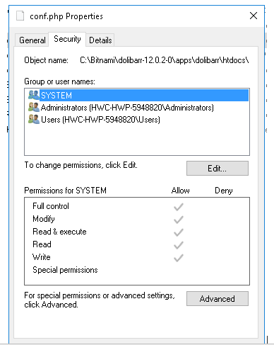

Ok thanks a lot. Trying to do it now and updating you soon.
My system is with Windows Server 2016 Box. I changed the permission to Full control for the file conf.pho under C:\Bitnami\dolibarr-12.0.2-0\apps\dolibarr\htdocs\conf Folder. I Changed to Full control for Users group. As shown in the picture below. But still its taking me to same page.

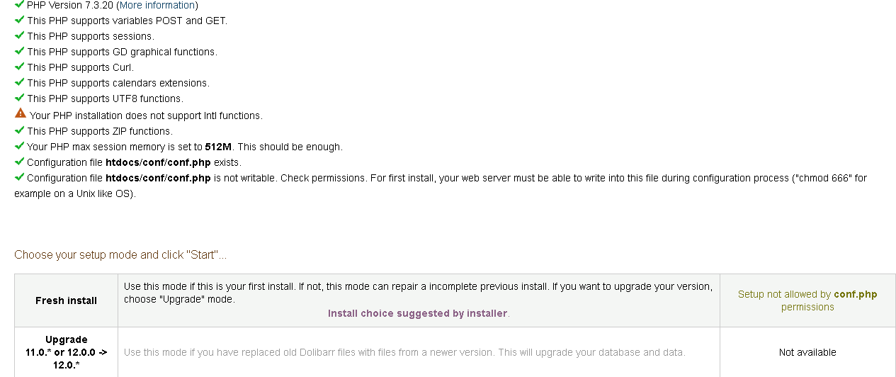

Here is what it is taking me the first time.
When I am clicking it it is taking to the page as shown below:
Maybe another option is to use the new conf.php and paste the content of the old conf.php into the new one if you can’t get the permissions right.
