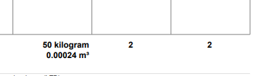

The volume stated on shipment sheets is not being calculated correctly. For example, when creating my shipment I enter 60cm, 80cm and 50cm for my package dimensions. This should result in 0.24 m3, but the volume shown at the bottom of the shipment sheet is 0.00024 m3.

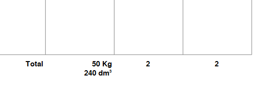

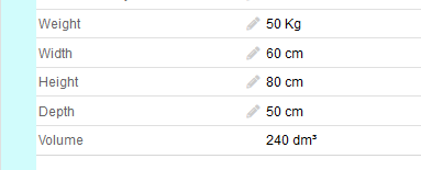

What ? See screenshots below of the shipment card and the resulting shipment sheet. It calculates the volume correctly on the shipment card (240 dm3), but the volume at the bottom of the shipment sheet is incorrect (0.00024 m3). It’s not converting between units correctly.

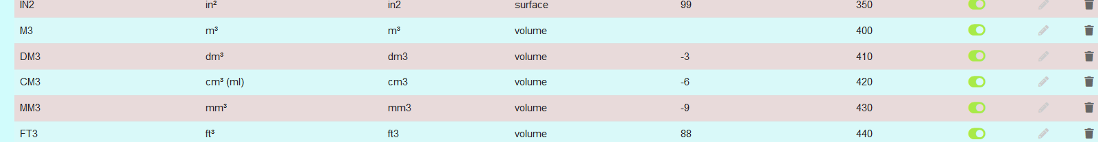

Home/Setup/Dictionaries/Measuring Units
On that screen, you can edit the “Scale” which controls the placing of the decimal point. In my installation, the scale is -6 for CM3.
If you took the 240000 cm3 and moved the decimal -6, you would get 0.24m3

Thanks. The measuring units in my system have a scale of -6 for CM3, and no scale for M3. I’ve tried setting M3 to various values but all this achieves is the m3 disappearing from the “0.00024 m3” at the bottom of the shipment sheet. All I get is “0.00024”.
I think the problem is only in the espadon document template. How do you configure this template ?

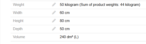

I checked this on V 17.0.2 with template “espadon” out and the result is as expected:
My setup s as follows:

In my setup there are no values in the sort order column. Will this make any difference ?
I also see that in your setup there is no value in the scale column for M3. Mine has the value 1, and gives an error if I try to leave it blank.
I’m still getting 0.00024 m3 instead of 240 dm3.
