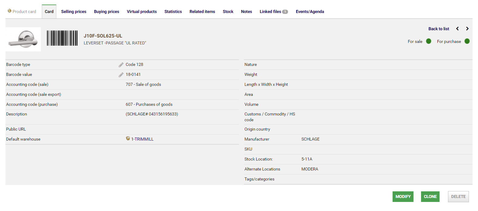

In our particular setup, I have created primary locations and also a secondary long string field for any secondary locations for products. This does not have the ability to reflect what quantities are in those locations, but does allow us to find product. The only way to separate the product into an actual “locations” would be to create individual names as Withheld stated in an earlier post (and we have done the same with ours). This helps when removing an item on a ticket as you can pull if from either your main warehouse stock or a sub of that, thereby reducing the amount only in that location.
I am attaching a picture so you can see the field of primary and secondary locations.
Hope this helps. Dolibarr is a great system and they are always improving it!
