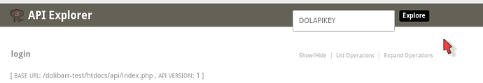

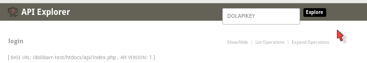

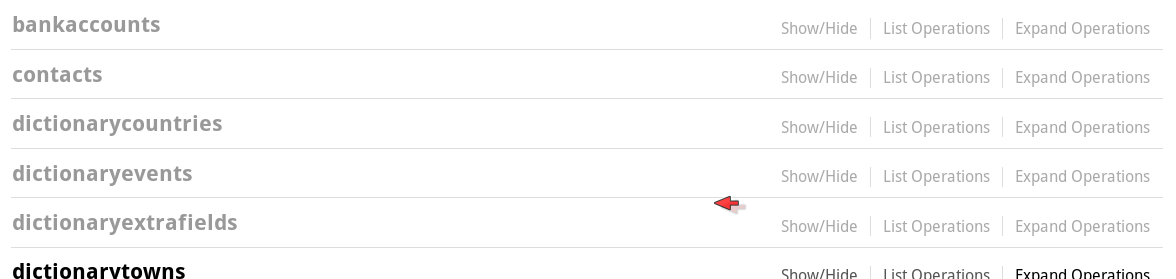

Here the steps I used to access the API:
In module I activated API/REST module.
In users/groups, on my profile, I edit the profile. I regenerate the API key, then copy it.
I go to the link:
htdocs/api/index.php/explorer (prefix with your site base)
I get :
I paste the key in the DOLAPIKEY field, then click Explore.
I get the list of services

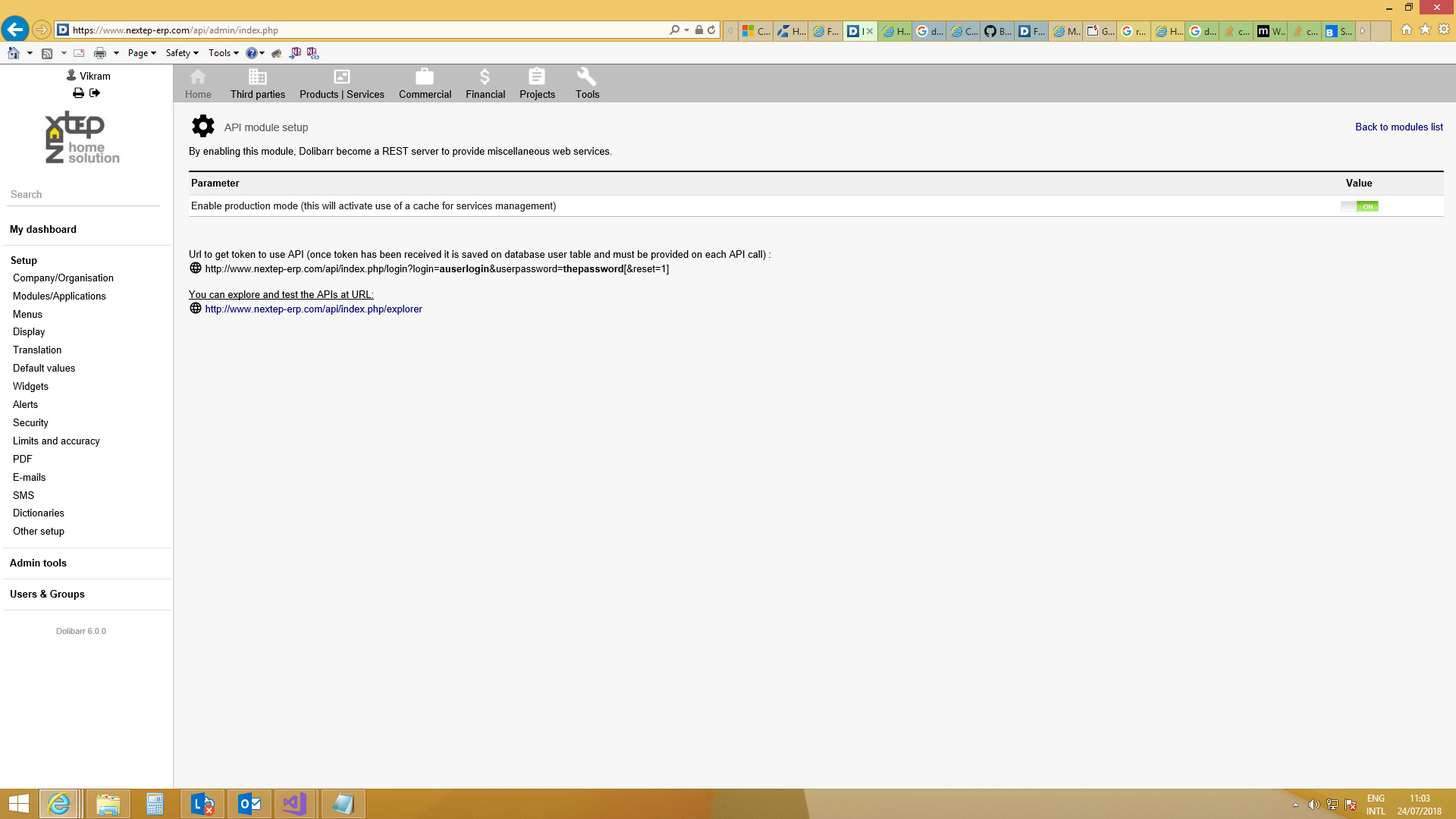

Thanks for your help however I did the same thing I cannot access API explorer.
I also regenerated the API Key in Users and Groups. My problem is I have the link for the API explorer displayed in REST API Module but it does not work. It gives error 500.
Pls find screenshot.
Thanks.
Pièces jointes :
- DolibarrRest.png (180 KB)
Something is wrong in your installation. With the link to reset the key, I get an XML file as return.
Try to get a proper installation, or debug the error within log files.
