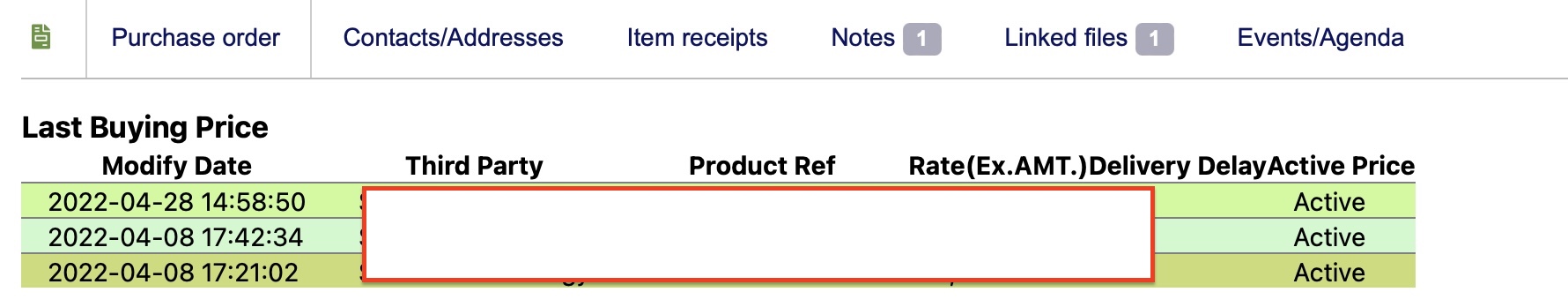

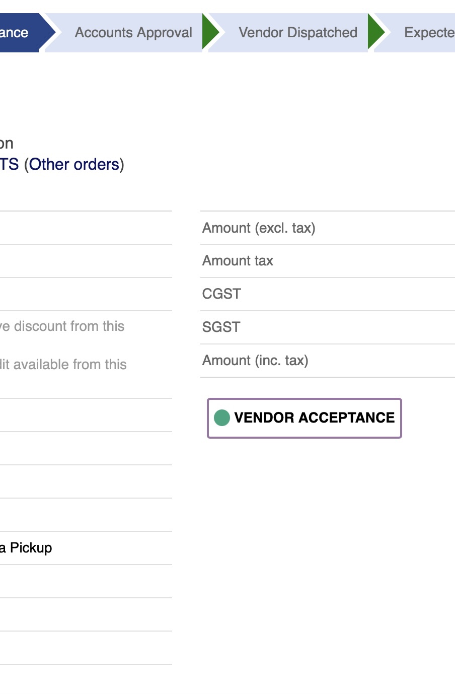

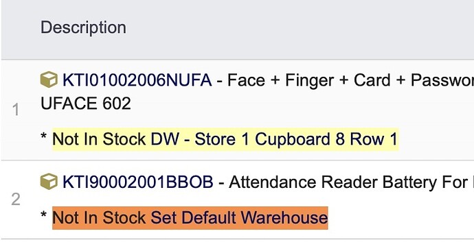

A few things I can recall have been attached as screenshots below:
  1. Different Stages of PO
  2. Different Buying Prices on the top of the page when PO is Validated & Yet not ordered. To help with the approval decision.

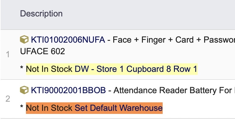

  3. Since our Reception is significantly controlled, we like to set which warehouse to use when creating a purchase order. Thus, on our purchase order page, each line will show if there is stock available or not, if not then if its default warehouse is defined or not.

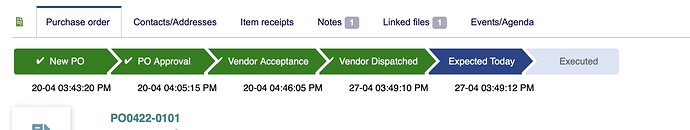

Hi Geettanna,
Your screen shot of purchase order status along with the dates looks impressive. Can you kindly share that code please.

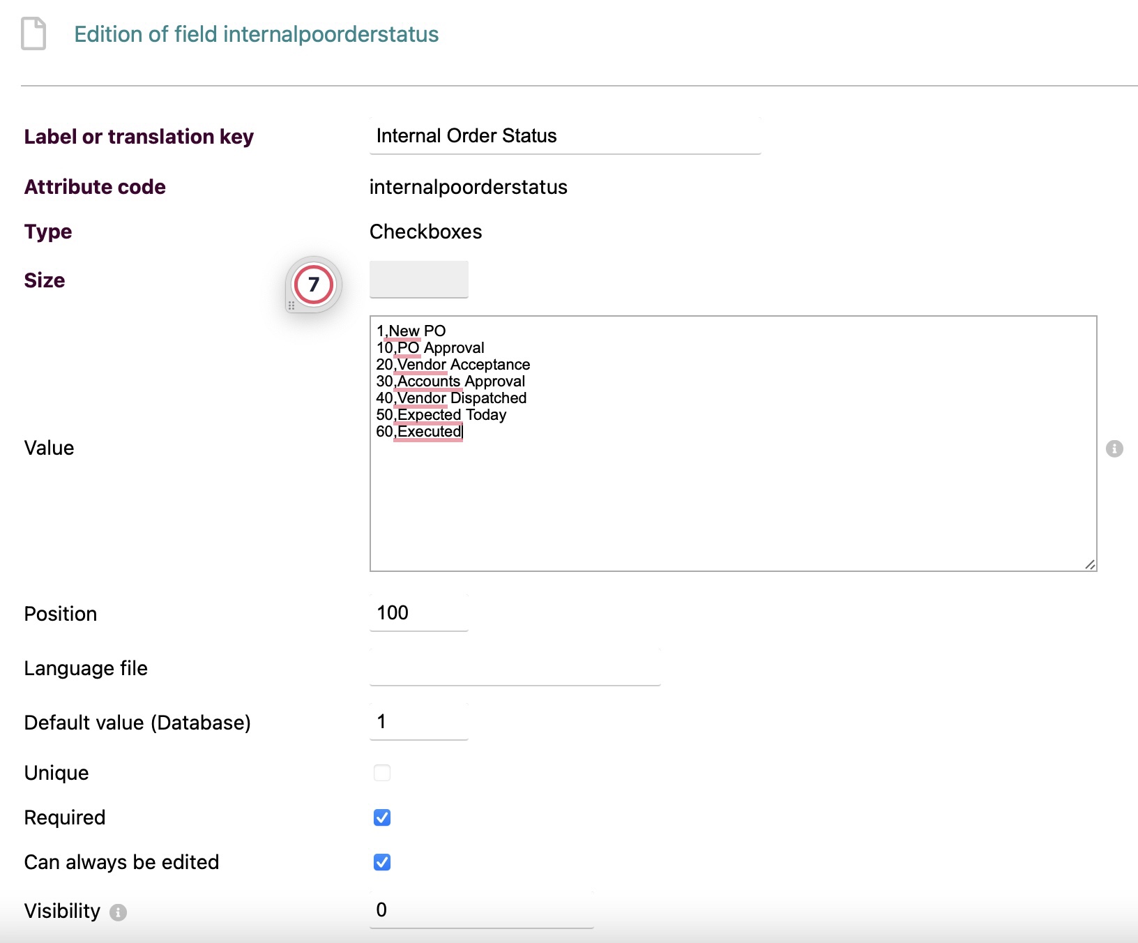

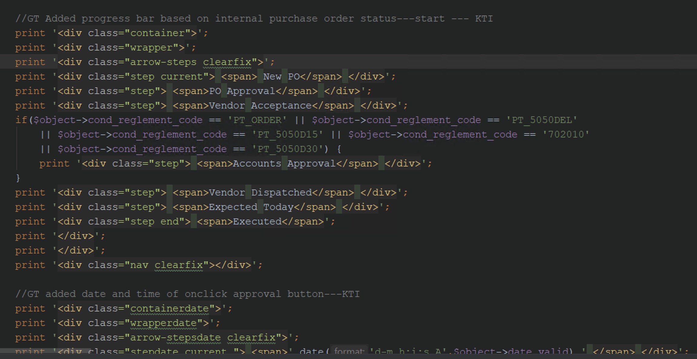

To explain a little more about the stages of Purchase Order, please find a little more explaination below:
1 - Add an extra field in Purchase Order.
2 - Add stages on PO Page.
If you want to manually handle the change, then make the field visible and change it accordingly.
While we use buttons along with permissions.

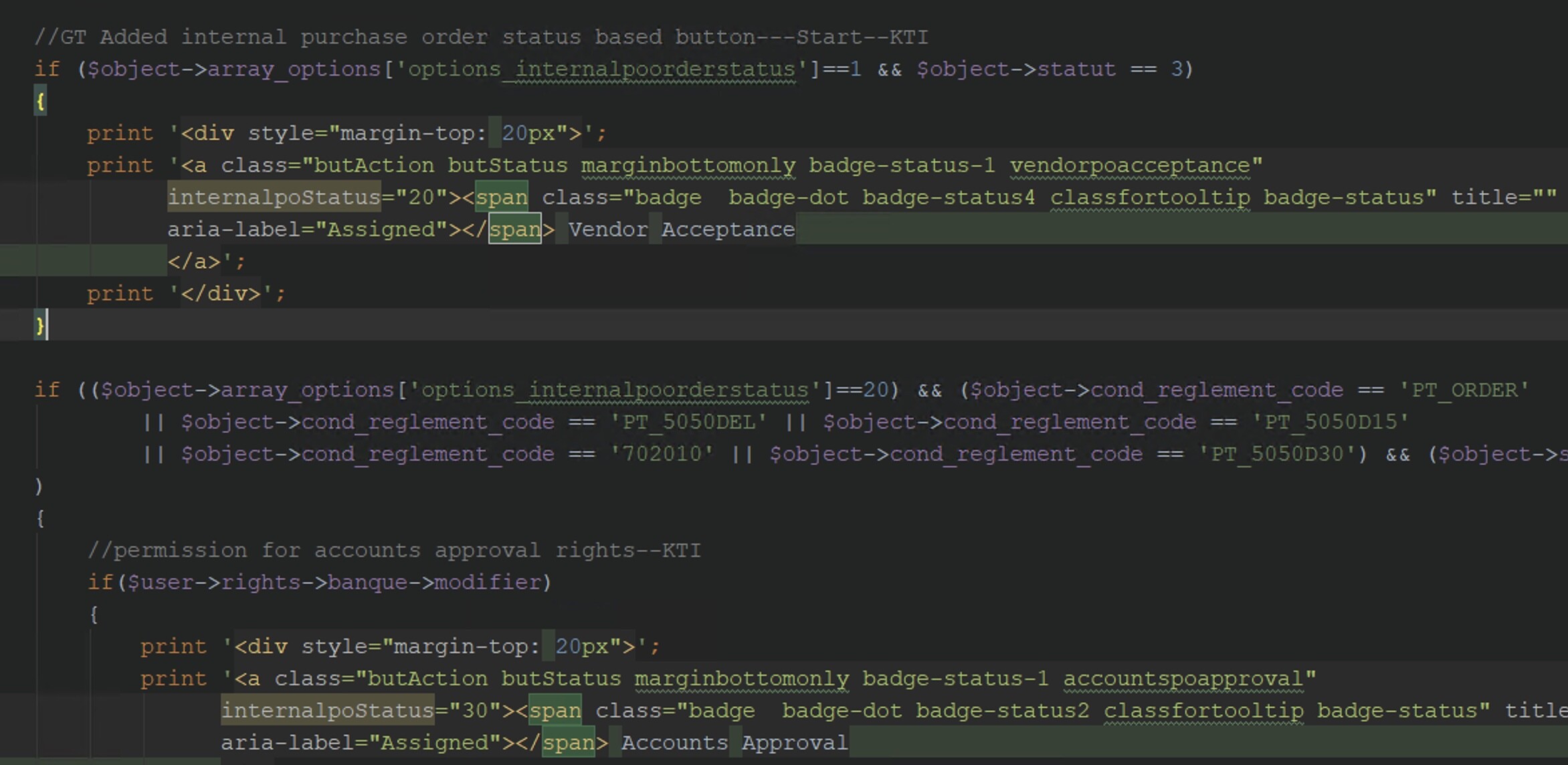

If you want to add buttons for better user experience:
3 - Code for buttons. Set persmissions as per your requirement.
They look something like this:
Use the file similar to our internalpoorderstatus_change.php as per your requirement.
