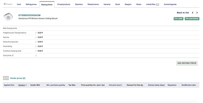

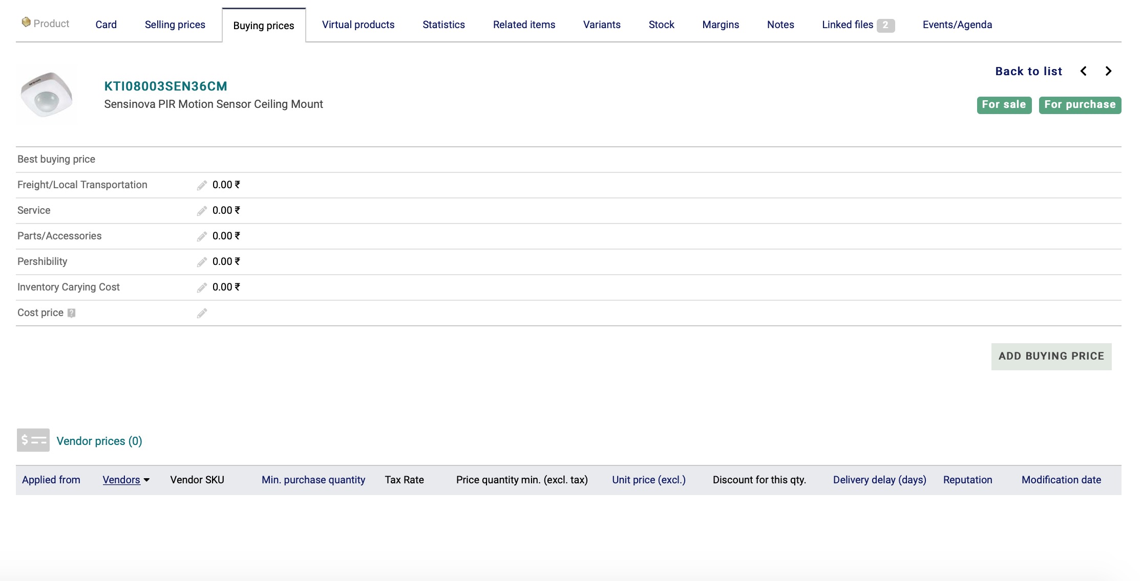

Every product page has a selling price & buying price tab.
We have customized it to work in a way where the selling price is influenced by the buying price. We have also added extra cost fields to add in the buying price tab.

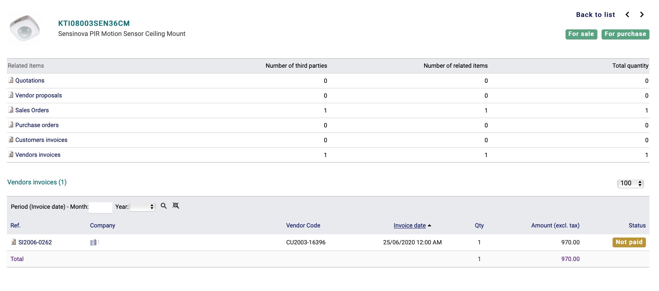

Now, the problem I am facing is that when we add vendor invoices, we expect that the buying price tab to add the price at which we bought from the supplier.
It has all the information it requires from the vendor invoice, so why does that not automatically work?

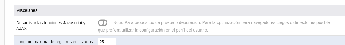

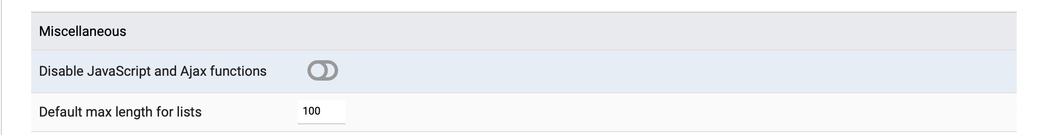

Favor revisa en la configuración global del sistema
Esta opción debe estar en OFF, ya que es necesario para ejecutar código javascript

That option is off at the moment. I have tried with off and on both the options.

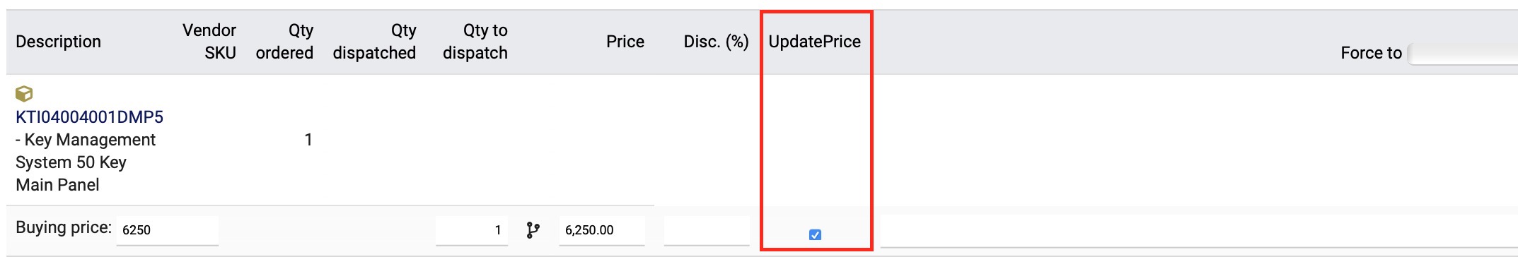

As per the link below, I followed all the steps & yet unable to add buying price directly from when receiving the order.
Thus, @eldy was mentioned in my response, since he made those changes, he would know a little more on what to try if the code does not prompt the expected behavior.

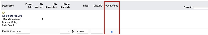

I can see the Update Price checkbox while receiving items in purchase order, but it is not reflected on the buying price tab for the product.

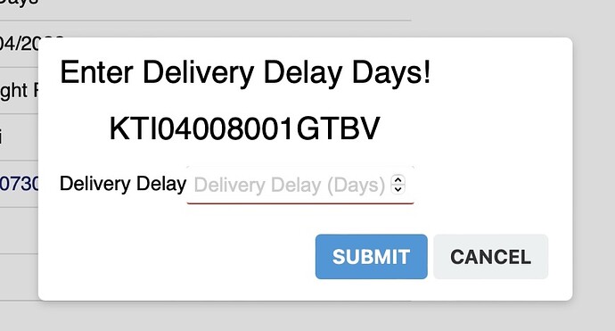

Dear @Hashim,
Good to see some more traction on such important topics.
We did not find a solution to this problem directly but made a workaround in a way.

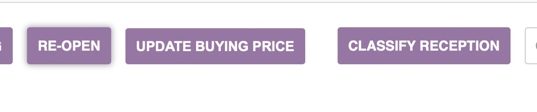

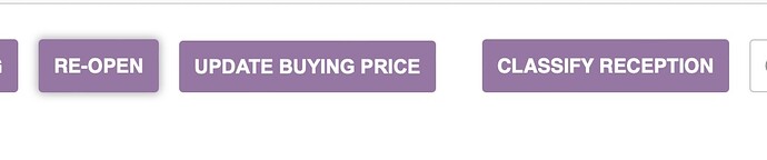

We created a button on the Purchase Order page, which allows adding a buying price directly.
I have added the following code to the file - \fourn\commande\card.php.
if($object->statut >=2 && $object->statut <= 3){     if($user->rights->fournisseur->commande->commander) {
> print '<input type="button" class="butAction" id="update_price"  value="Update Buying Price">';
//GT Added Update Buying Price button --- KTI
//GT added update product price --- KTI
$count = 0;
$nooflines = 0;
foreach ($object->lines as $productrow) {
  <link rel="stylesheet" href="<?php echo DOL_URL_ROOT; ?>/includes/jquery/css/jquery-confirm.min.css">
     <script src="https://cdnjs.cloudflare.com/ajax/libs/jquery-confirm/3.3.2/jquery-confirm.min.js"></script>

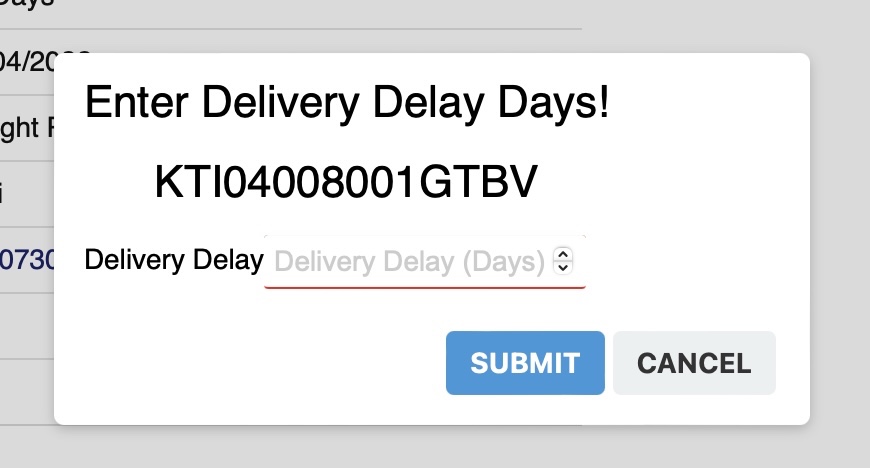

     <script type="text/javascript">         $(document).ready(function() {             $("#update_price").click(function ()             {                 $.confirm({                     title: 'Enter Delivery Delay Days!<?php echo "<center></br>".$productrow->ref; ?></center>',                     content: '' +                         '<form action="" class="formName">' +                         '<div class="form-group">' +                         '<label>Delivery Delay</label>' +                         '<input type="number" placeholder="Delivery Delay (Days)" class="delay-days form-control" required />' +                         '</div>' +                         '</form>',                     buttons: {                         formSubmit: {                             text: 'Submit',                             btnClass: 'btn-blue',                             action: function () {                                 var delaydays = this.$content.find('.delay-days').val();                                 if(!delaydays){                                     $.alert('provide a valid delivery delay days');                                     return false;                                 }                                  var thirdpartyid = "<?php echo $object->socid; ?>";                                 var productid = "<?php echo $productrow->fk_product; ?>";                                 var productref = "<?php echo $productrow->ref; ?>";                                 var price  = "<?php echo $productrow->pu_ht ?>";                                  var user_authorid = "<?php echo $object->user_author_id; ?>";                                 var tva_tx = "<?php echo $productrow->tva_tx; ?>";                                  var currentdate = new Date();                                 var datetime = (currentdate.getFullYear())  + "-"                                     + (currentdate.getMonth()+1) + "-"                                     + currentdate.getDate() + " "                                     + currentdate.getHours() + ":"                                     + currentdate.getMinutes() + ":"                                     + currentdate.getSeconds();                                  $.ajax({                                     type: 'POST',                                     url: 'update_buyingprice.php?thirdpartyid='+thirdpartyid+'&productid='+productid+'&price='+price+'&user_authorid='+user_authorid+'&tva_tx='+tva_tx+'&datetime='+datetime+'&productref='+productref+'&delaydays='+delaydays,                                     dataType: 'json',                                      success : function(response) {                                         //success msg                                     }                                 });                                 // alert("Buying Price Has Been Updated Successfully.....");                             }                          },                         cancel: function () {                             //close                         },                     }                 });             });         });     </script>     <?php     $count++;     $nooflines++;      if ($count > $nooflines)     {         break;     } }
And add the following file:
update_buyingprice.php (2.6 KB)
It will give you something like this on the Purchase Order Page:

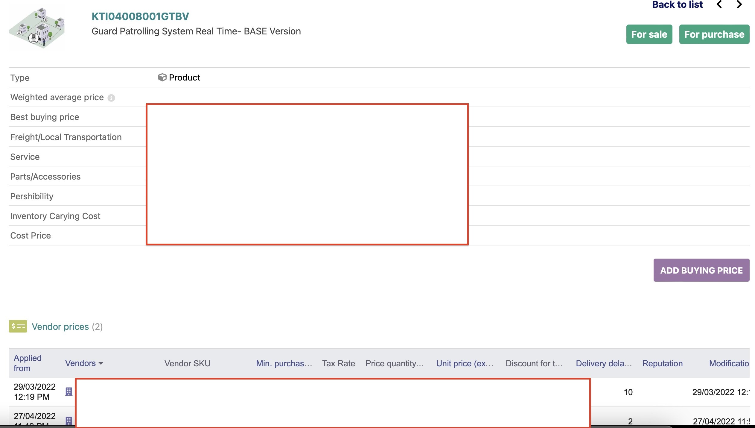

When clicked it gives the following pop up to enter the dispatch delay for the product ref:

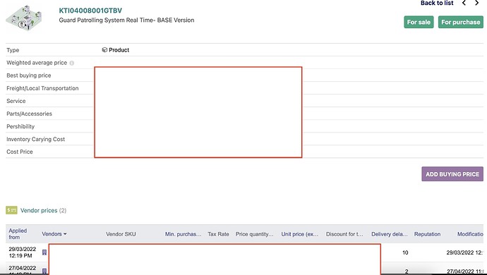

On submit it automatically adds or updates the buying price (based on if there is an buying from the vendor from the purchase order or not):
One last thing, if you plan to implement this, please remember, we have an extra field for adding active & inactive buying prices, so the code will have that as well, which you might want to remove before implementation so the query does not give any errors.
We have this extra field to add prices from multiple vendors, but still use only “active” buying prices for automatic selling price calculation.
