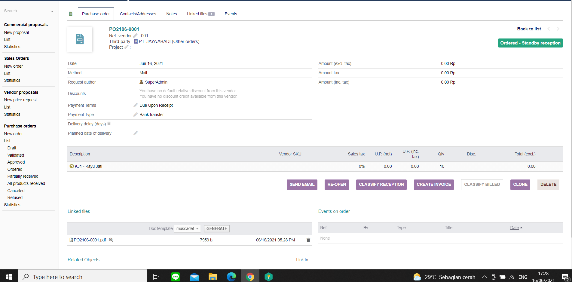

Why the item receipt button doesn't appear on my dolibarr?
Hello, I tried to use a purchase order and have already make an order, but the item receipt button doesn’t appear and only classify receipts appear, how do I display the item receipt button so that the purchased product will automatically increase in stock?

Please Check:
Home–>Setup–>Modules–>Stock - Setup
To increase stocks on manual dispatching into warehouses, after supplier order receipt of goods - select Yes
On the purchase order you can create a reception of goods.
If you activated the reception module the button “Received Items” is replaced by “Create Reception”
There you create a reception and you can find all the created receptions on the product tab.
