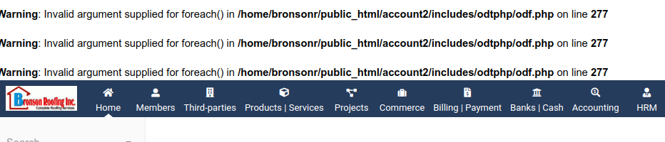

Warning : Invalid argument supplied for foreach() in /home/bronsonr/public_html/account2/includes/odtphp/odf.php on line 277

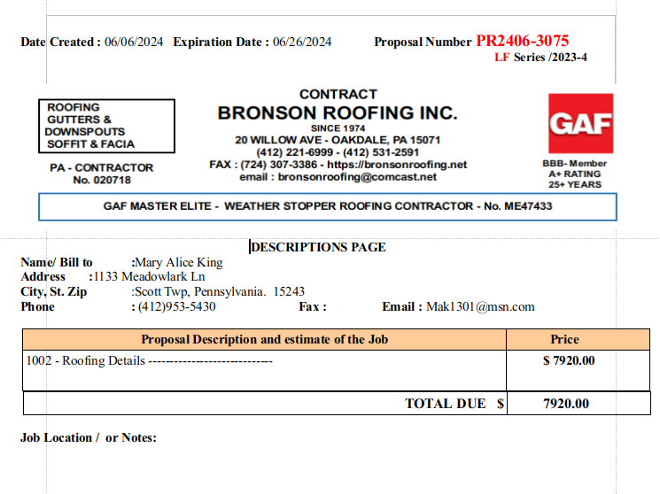

I am using 19.0.2 this same problem has existed since version 16 and has never been fixed it creates the template but the item prints only the top line of the item not the full line see image here this is what I get

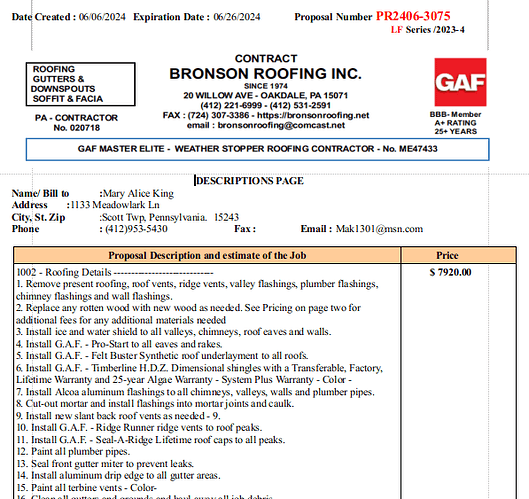

This is what I’m supposed to get this one made on version 11.0.4

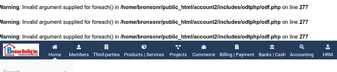

it works correctly on 11.0.4 but not on the latest version It also displays an error at the top of the page indicating that there is an error in the odtphp file shown here

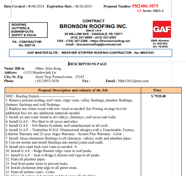

I have replaced the whole folder with the version from 11.0.4 and it works correctly

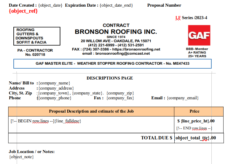

The template
Template looks good.
Trouble may be in the content of line desceiption. Can you try with a description of 3 lines only, and remove the ------ into it.
