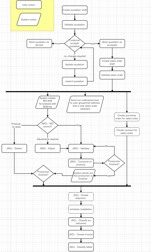

I’m new to Dolibar and try to make it fit our company workflow. My question is for the biggerst part related to PM so for that reason i post it in that category. I made a flow diagram of the company work flow to support my question(s).
How can i achieve the folowing in Dolibar:
  • Dolibarr should create the “manufacturing orders” (draft) for all products with a BOM-list inside a validated “sales order”

Thanks for your reply. It definitely contains some useful info for me but unfortunately it only “solves” a part of my question (“Bad thing is that I cannot see the option for automation i.e. auto-create MO”).
It would already help if i could send out notifications when a sales order is validated, a manufacturing order is validated and a manufacturing order goes to the status “produced”. This way we can use a workflow manually by just doing the correct actions at a notification. Continuously monitoring sales orders and manufacturing orders is not where unworkable for us.
