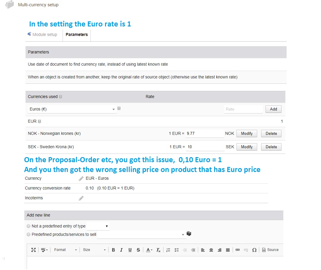

Wrong rate on Supplier Invoice and multi currency
DOLIBARR ENVIRONMENT
- Version: 8.0.0
If The Main Company Currency is in Euro.
you making a Supplier Invoice in Euro,
The supplier has as Default Euro Currency,
Then on the Supplier Invoice you got :
Currency conversion rate 0.10 (0.10 EUR = 1 EUR) and you cant change it.
So if you by from suppler a product that has EUR currency, the invoice getting wrong.
The Currency conversion rate must be set to 1 (1 EUR = 1 EUR)?

I found an solution, so it was not the script on 8.0.0 and 8.0.2 that had the problem, it must be in the DB.
The only way to fix it was to make a new DB. so now it works, now it shows 1 (1 EUR = 1 EUR) it must be some from older version that not handle upgrade,
I not help to upgrade the script, it was in the DB.

Same issue here, and I’m using ver.13.0.3.
Selecting same currency with company default currency in Proposal doesn’t give 1:1 conversion rate.
