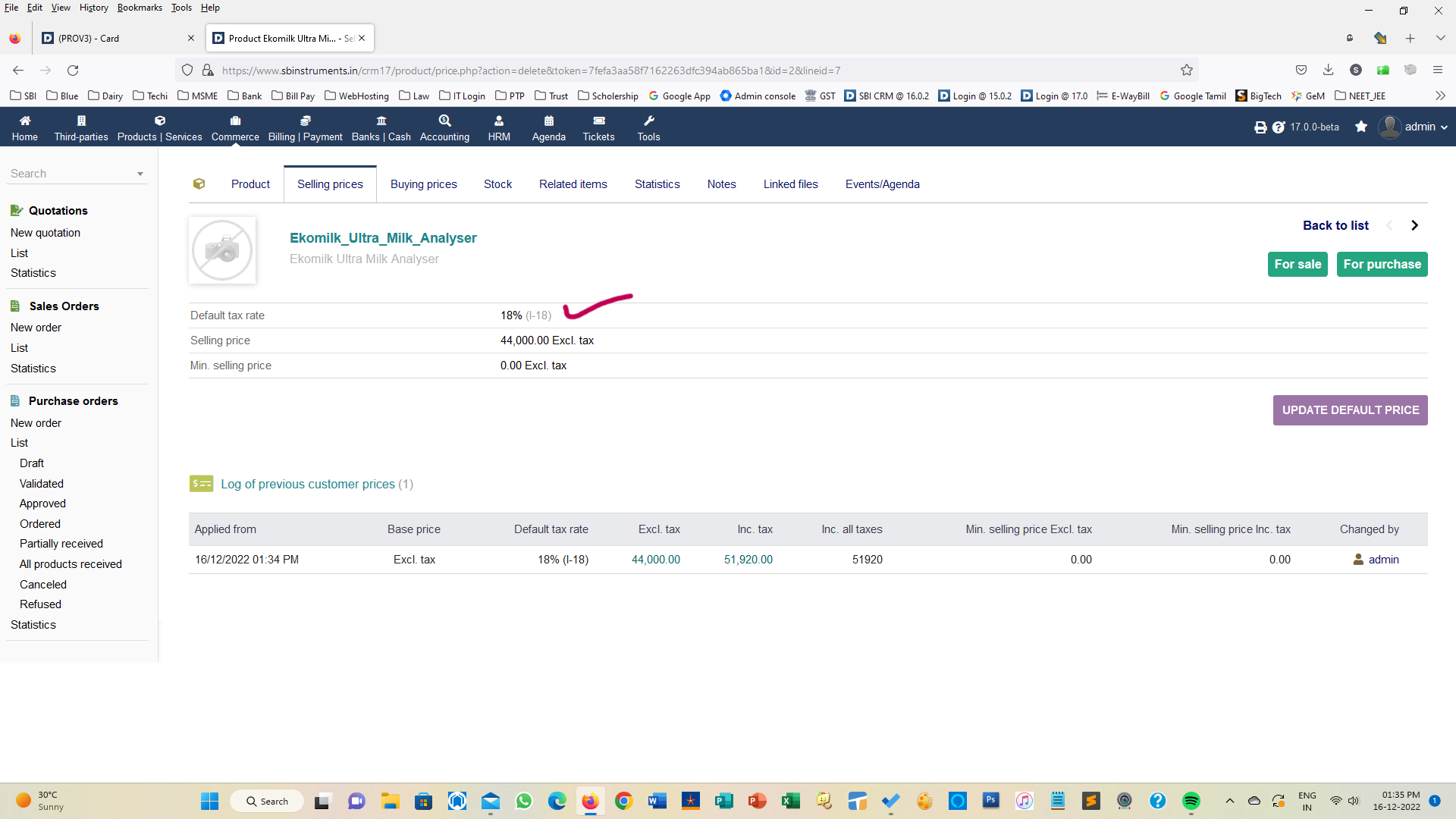

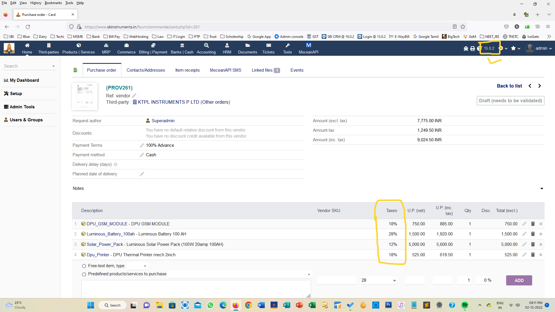

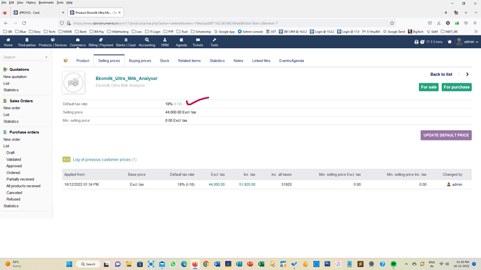

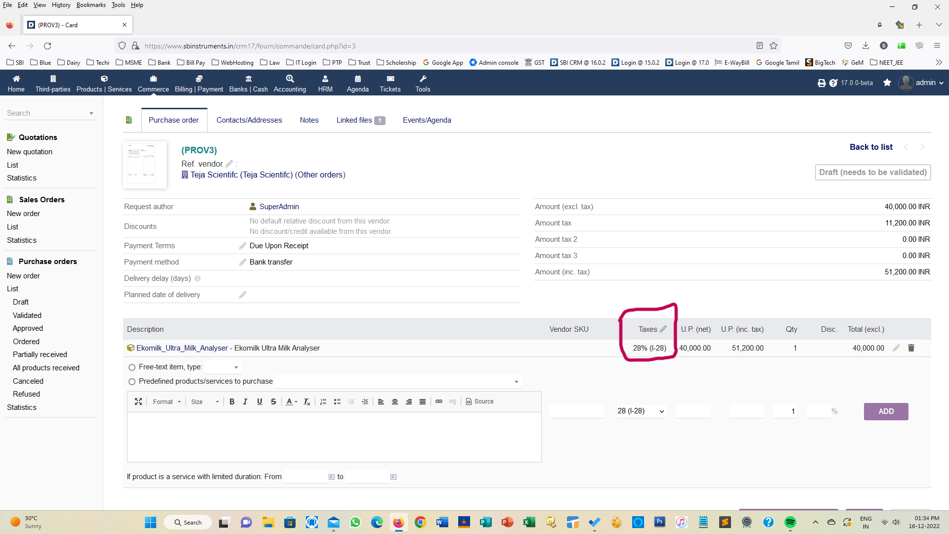

While creating PO the system shows wrong sales tax of a product, this problem is persist from V16. I was excepting the correction in 16.0.2 but it is still persist. Kindly do the needful. the new users of our Dolibarr did know about the product tax rate. so they are making this mistake and we are facing serious problems.
Please see the attached screenshot

You are on a Purchase Order. So the vat is not defined by the selling price (this is for sale orders) but must be defined into the “Buying prices”

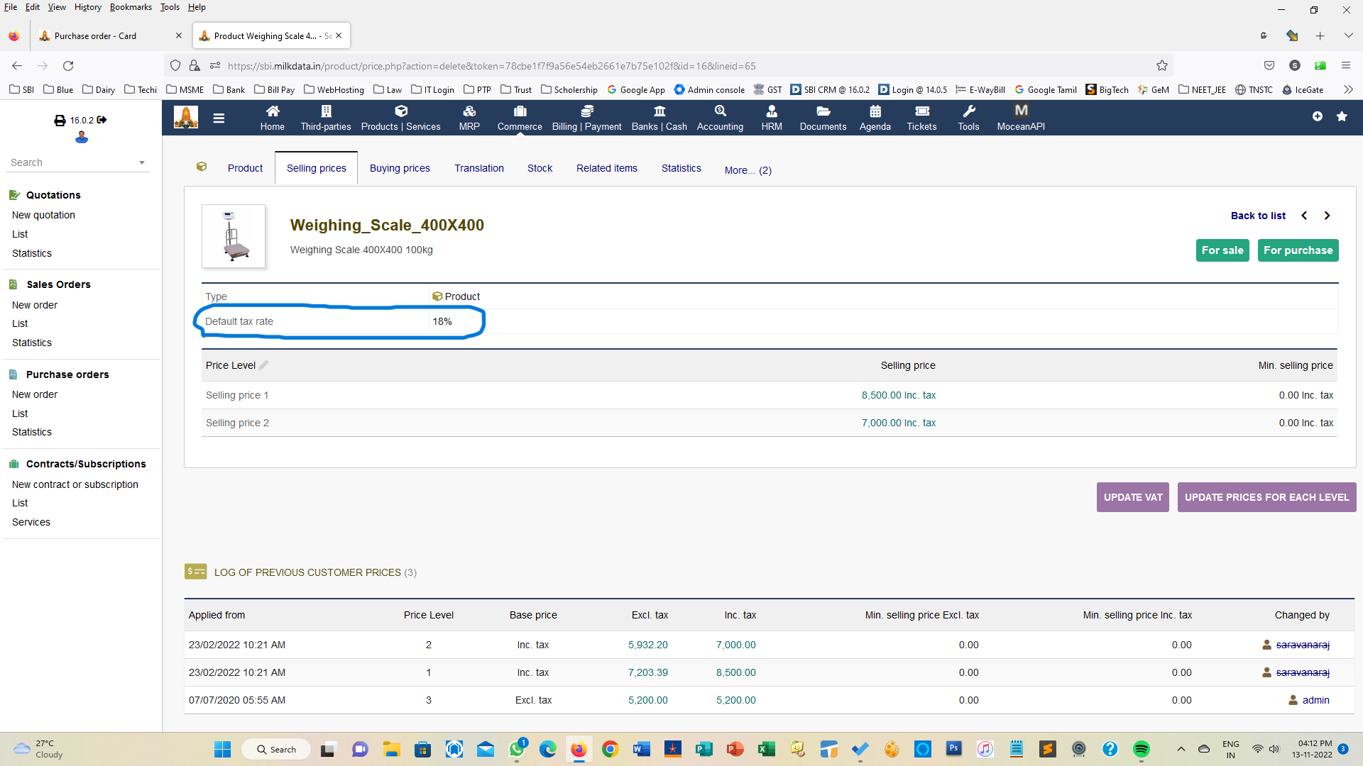

In previous version (15.0) the system uses Default VAT rate for creating any card. I have still V 15.0 installation running in another test hosting. I have double checked your reply. Please see the attached screen shoot, for that particular product i have tested, there is no buying price defined, but system correctly working using default vat rate of that product.
When there is no buying price defined, the system use a default value for vat rate.

So far we never defined buying price in any product (we are using dolibarr last two years). It worked good until V15. The system was using default vat rate. From V16 onward system looks dictionary and assign higher VAT rate 28% which is not relevant for many products.The Vendor and we are in the same Country.

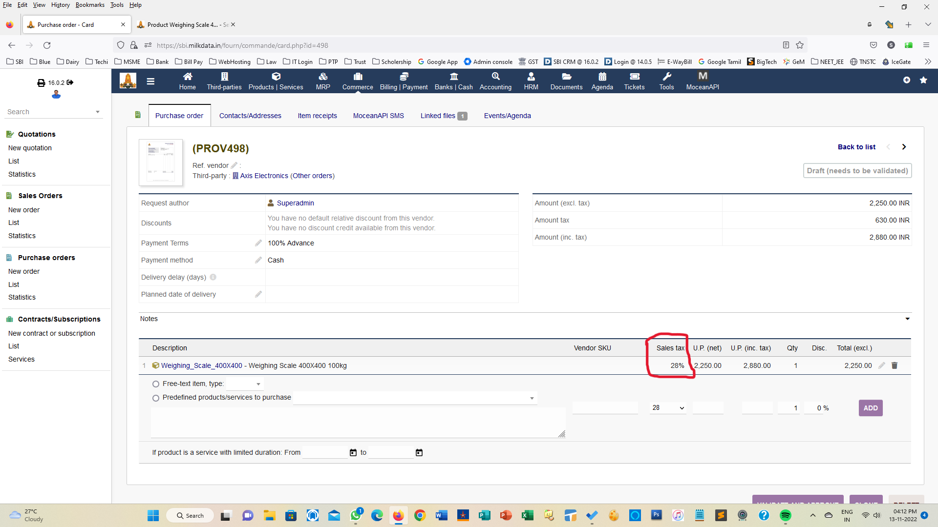

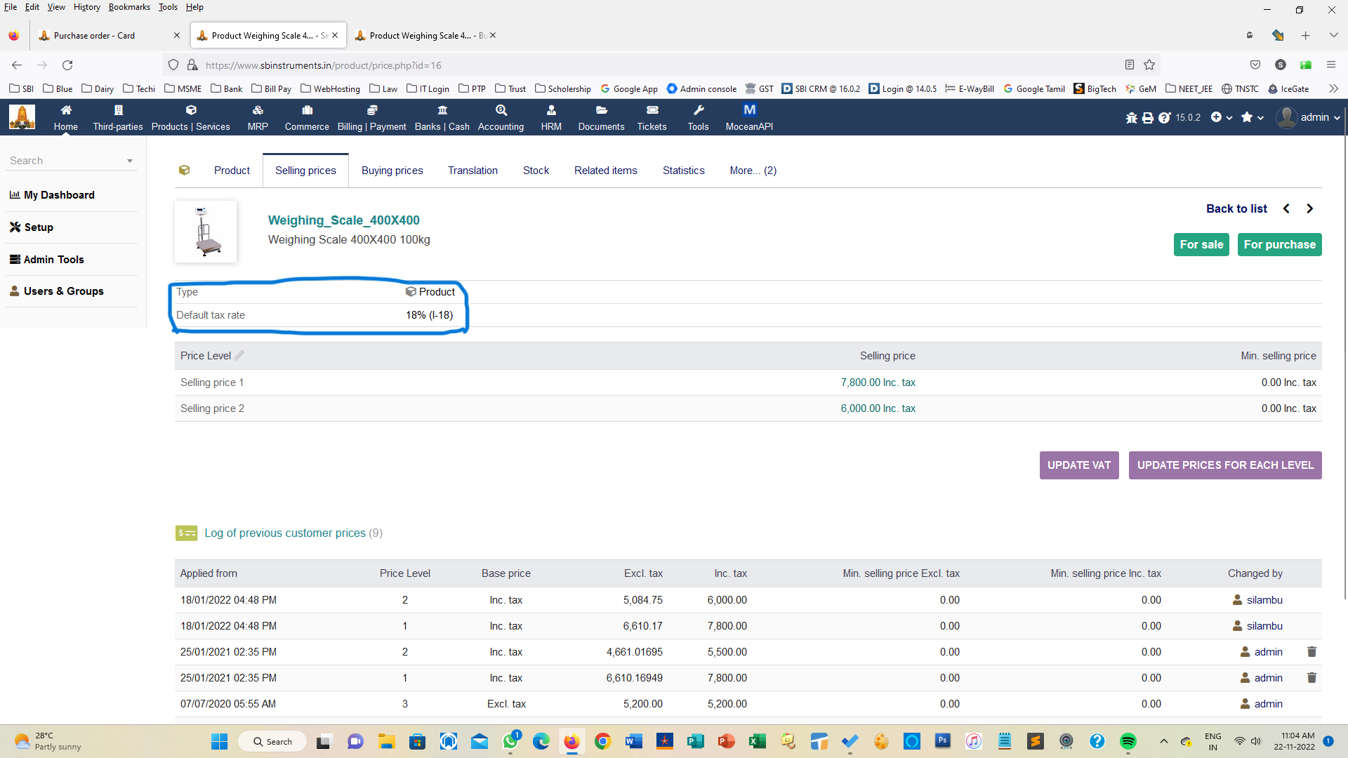

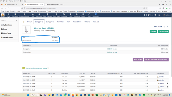

I have again checked with V.15.0.2 with all VAT rate it works fine (please see the attached screenshot).
Please Note:-
- In V16.0 the problem persist only in Purchase Order creation and no issue in other places like sales order and Invoice.
- In V 15.0, the system uses the default vat rate defined in product card at Selling Price—>Default tax rate.

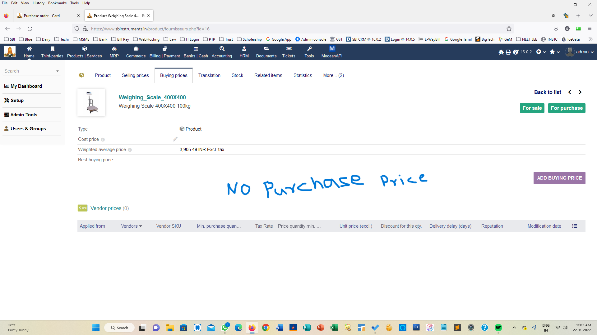

- there is no Default vat rate defined for any product at Buying Price also there is no such a place to define vat rate like one available at Selling Price tab.
So I am experiencing the issue in V16.0 is the system not bringing Default tax rate from Selling Price tab (only in Purchase order creation).

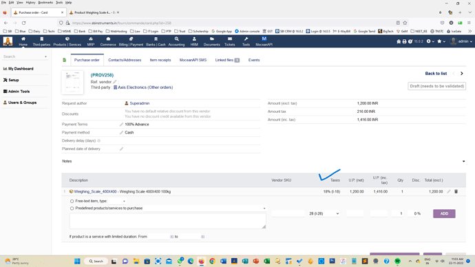

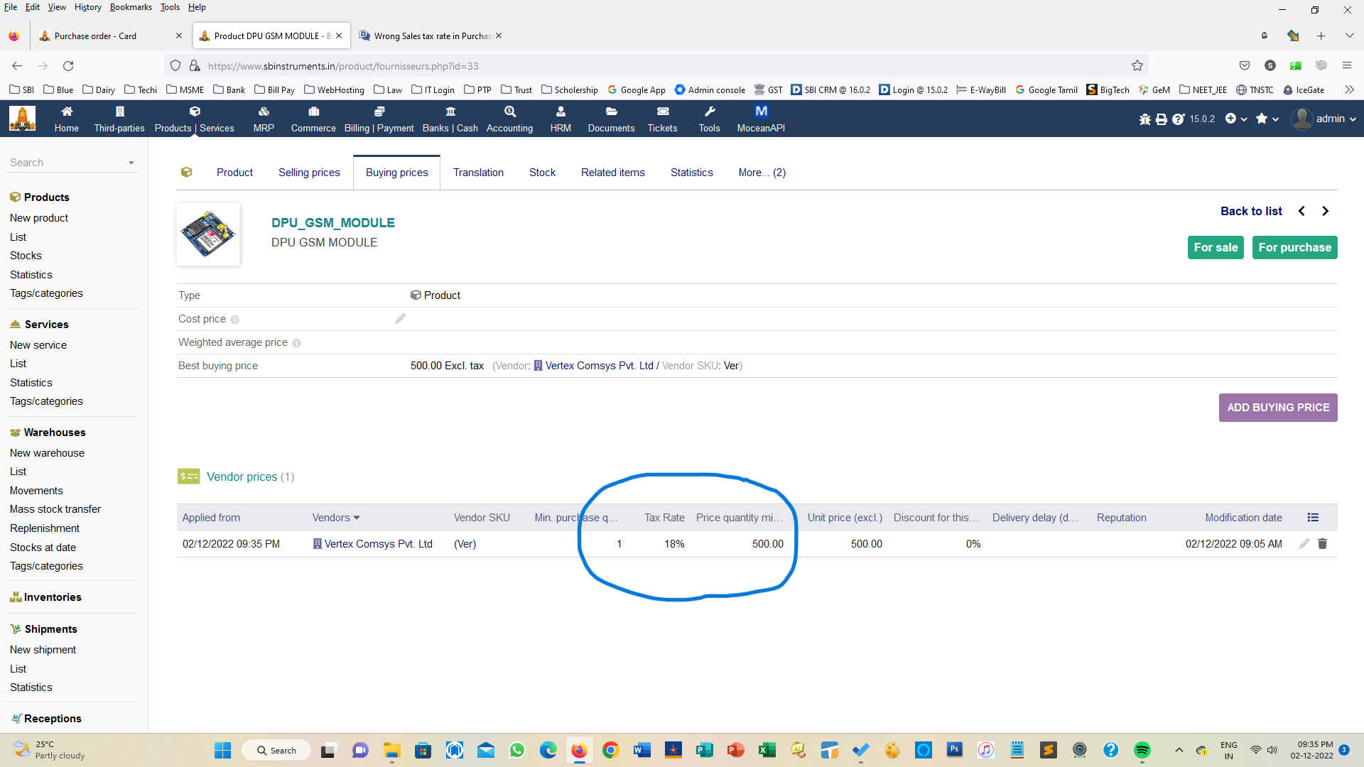

Unfortunately I could not use the constant MAIN_VAT_DEFAULT_IF_AUTODETECT_FAILS rather I can manually set vat rate at Buying Price for all the product to use the higher version. (please see the attached screenshot)
Thank you for your valuable support

I would like to add, The VAT defined at buy price is only works for that particular vendor only and if I create PO for the same product but buy from different vendor than system assigns different VAT rate.

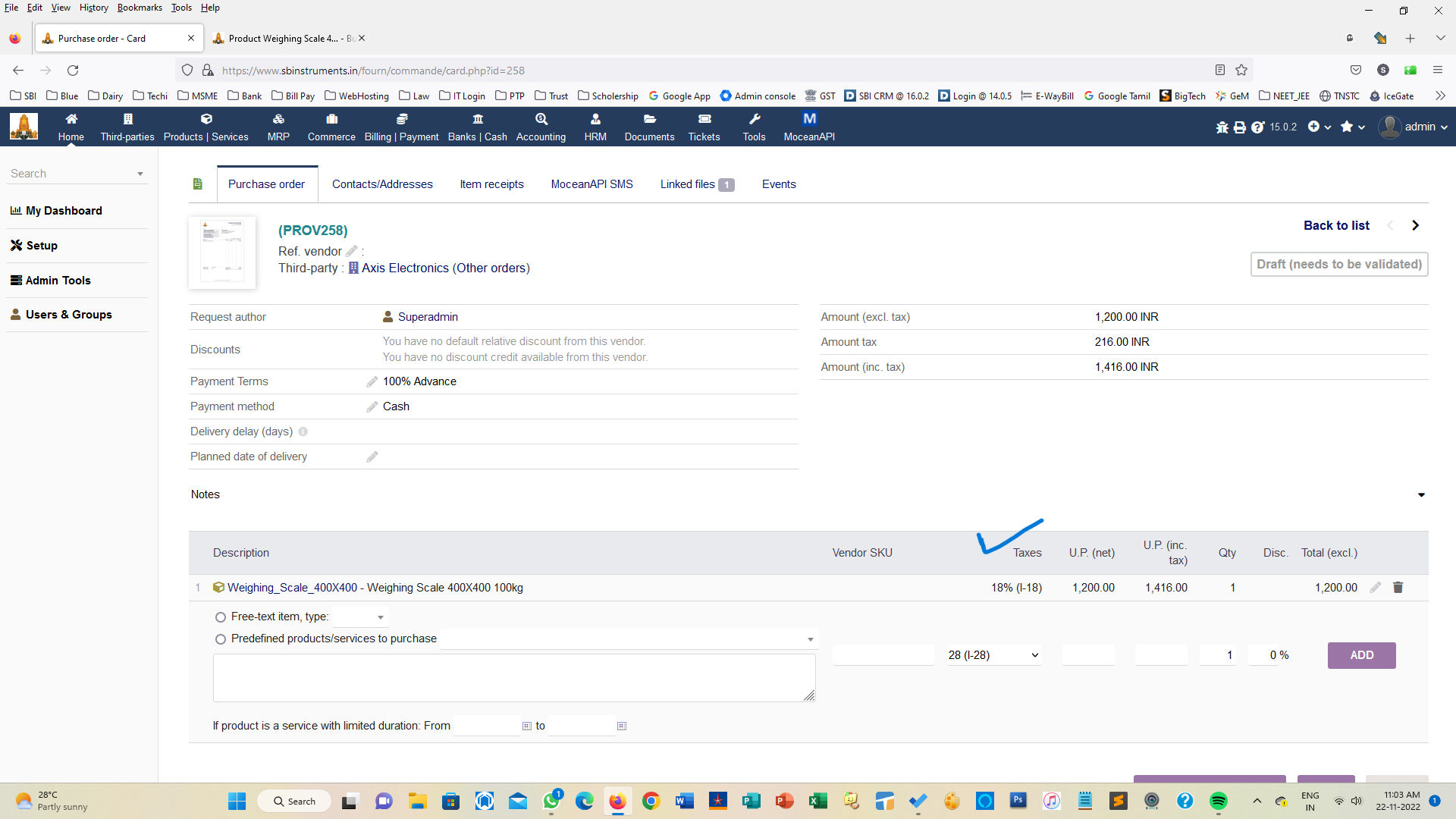

I have tested the option in 17 Beta (Change is inside get_product_vat_for_country() function) but it is not working. please find attached screenshot for your reference.
Sorry, my fix was not complete.
I have just pushed into 17.0 branch, a better fix.
Great job!
This issue has been solved in V17 beta. also I found a wonderful feature U.P (net) and U.P (inc. tax) in Invoice creation (Now easy to make invoice).
