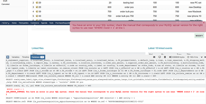

Yes i already activate the debug bar this is what i see
It says the line is WHERE

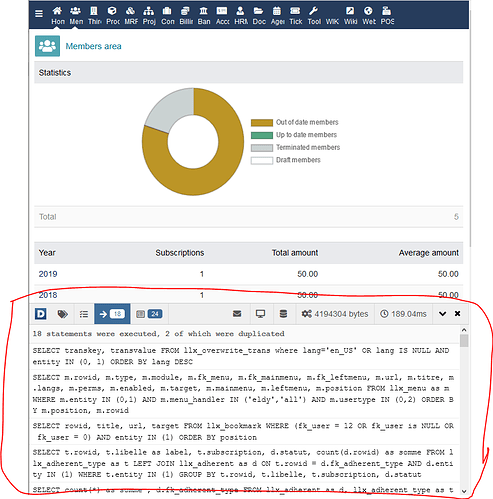

Debugg bar is a module that you need to activate.
Then you will have this :

Yes i activated that. this is the error
it clearly says
  • WHERE rowid = 1 [DB_ERROR_SYNTAX] You have an error in your SQL syntax; check the manual that corresponds to your MySQL server version for the right syntax to use near ‘WHERE rowid = 1’ at line 1
