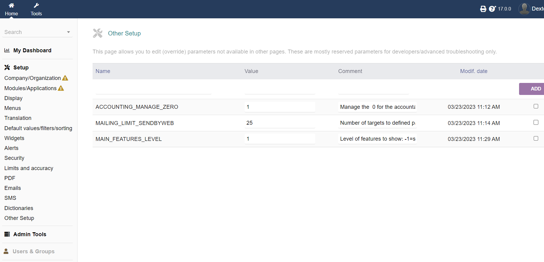

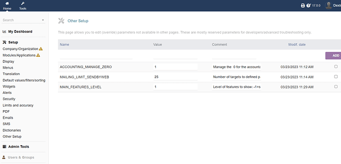

So what I had to do, in order for this to work. I took what ksar told me, instead of using PHP manager I went into ‘Other Setup’, i added MAIN_MODULE_USER with a value of 1 then I went to MAIN_FEATURES_LEVEL and gave it a value of 1 as well. It then ungreyed the Users & Groups.
For some odd reason though, it will toggle every so often after not changing anything and clicking ‘Modify’, for instance i will change the features level back to 0, click modify and users is greyed out again. Or sometimes i will change to 0 back 1 click modify and it greys out. It’s very strange will say that.

Sorry I had missed this part from your reply, this worked!!! Thank you! what is this and would impact any other functions?
I haven’t noticed any impact personally, however I am having an issue whereas it will grey itself out again after loggin out. I repeat the process and it works again, a possible bug?

This fixed my issue as well. Didn’t need to touch MAIN_FEATURES_LEVEL
yeah I had found that out after doing another installation that Main Features Level doesn’t need adjusting
