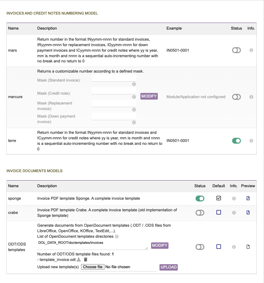

which invoice numbering and template are you using?
Using terre, but it looks like i found the problem in startup time of soffice. I created a systemd script now to run soffice as daemon and give unoconv a try. need to recreate the debian package, because on bookworm it still wants python 3.11
