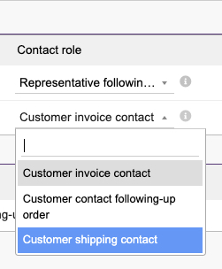

I think you can assign a contact to a to an Order, so I’d expect that you could do the same with a Purchase Order.
Looks slightly different for a PO
My hope is that if you choose a contact that has a different Contact, then that contact’s address will be shown on the order?

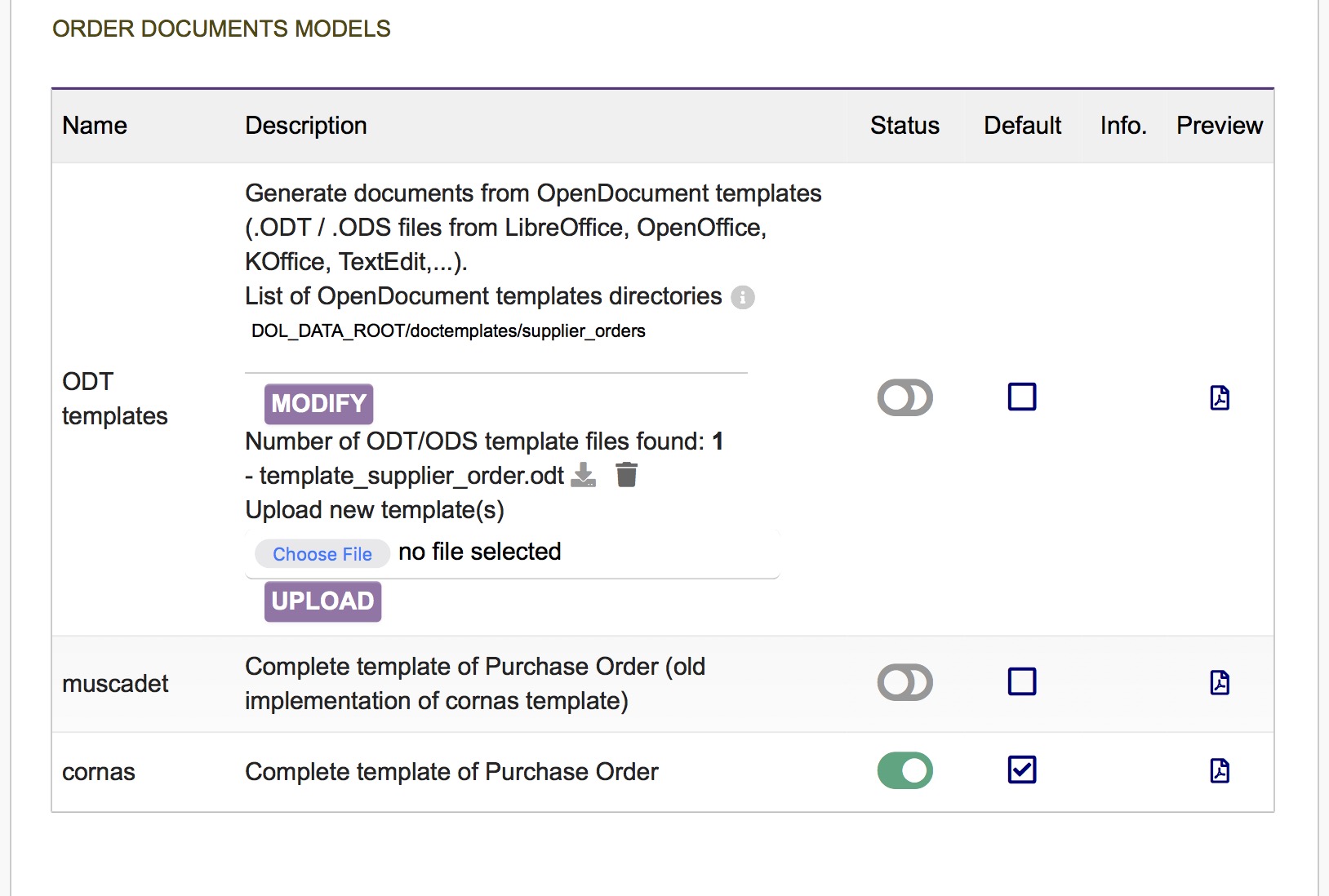

Which PO template are you using?
