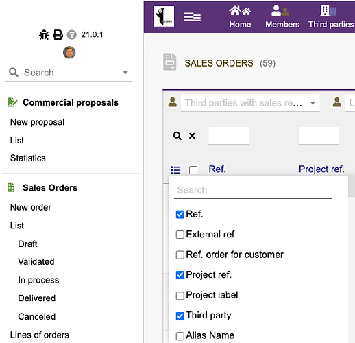

I do not use contracts, but in other modules you can add the extra fields to the list of objects in that module and then you can search in them. @S3R
@jonbendtsen Thanks thats good to know. But for my usecase I would like to search those fields without the need to display them all the time in the list view.. Best would be to search them and display them, in case the searchresult found a match in the field. But I would also settle for just searching them and not seeing the match in the list view at all. I have ~20 Extrafields I need for different types of contracts, most of those are empty for most contracts types, this would clutter the screen if I displayed them always.
@S3R how often do you have to change the search fields and the values you search for?
because you can make bookmarks in your browser that does that search - or use the STAR in Dolibarr
We have ~15 different contract types with ~25 different extrafields and ~2000 contracts. I know I can set it up in a way, that I can select the extrafield I need to search, in the list view, and then use the search bar on top of the column. This is my current workaround. It is however very unpractical to have to select the column, search, and afterwards delselect the column again. It is even more unpractical to show them all the time, given the number of fields.
It would be easier, if there was a way to add certain extrafields to the search in the top search bar. So that when I type in a number and select “contracts” I get all contracts that have that number as a part of any extrafield. Ideally showing the corrosponding extrafield column in the list view (but only for the search result, not for the “normal” list view)
