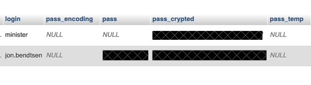

Here is a picture from my development dolibarr installation. I redacted the pass and pass_crypted values.
My guess is that if you put stuff inside the pass column for the matching username, then you can log in, but perhaps you have to clean out the pass_crypted column.
databasefields
