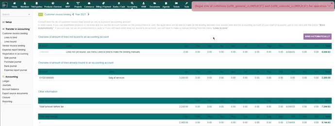

Hi there,
There have been a lot of posts of this topic and I even made a post myself, the fix back then was the force update:
Illegal mix of collations
Fix:
Error when checking Latest movement - Full List
But now I run into the problem again and this time face flat against the wall like last time, when trying to run the /install/repair.php?force_utf8_on_tables=confirmed nothing happens.
I have now tried to update the tables manually (I am no database expert) but now I get an error that the “specified key is too long”. I am a little uncertain what is wrong now.
Please see this screenshot and appreciate any support again :blush:
