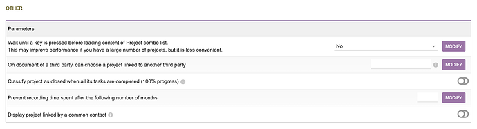

isn’t there already a slider for that? found here Project module setup
Hello jonbendtsen,
The option available in the Dolibarr module refers to automatically setting the project status to “closed” when all tasks are completed. However, this is slightly different from what I am trying to achieve.

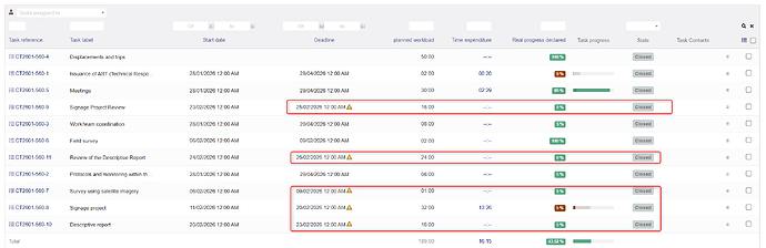

Each task has its own progress percentage, and when I close a task using the available button, the progress is not automatically updated to 100%. As a result, even though the task is marked as closed, it may still trigger overdue task alerts if the planned date has passed.
In practice, I have to manually update the progress to 100% for each task individually to avoid these alerts. Please see the example in the attached image.

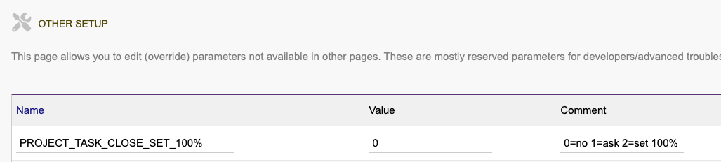

b) I think you should introduce a new configuration slider or enviromental configuration option or Home → Setup → Other Setup where it is possible to configure that when a task is closed it is set to, or asked if set to 100%. Something like this
