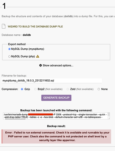

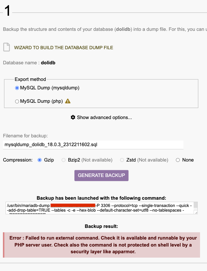

Error when backing up using Dolibarr, the following message appears in step 1:
Error: - MariaDB dump 10.17 Distrib 10.4.10-MariaDB, for Win64 (AMD64). Using the “MySQL Dump (mysqldump)” export method;

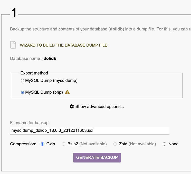

Using the “MySQL Dump (php)” export method, the file is successfully generated.
The error does not occur when backing up Mysql 5.0.45 Win7 Pro 64bit.
Error in step 1 with DB Maria 10.4.10 or MySQL 5.7.28 does not occur after upgrading to v11.0.1
In step 2, the following message is displayed:
Error: Tar generation error return Error 1
The error in step 2 occurs on Win 10 with DB Maria 10.4.10 or MySQL 5.7.28 and Win 7 with Mysql and no files are generated.
Error persists in step 2.
