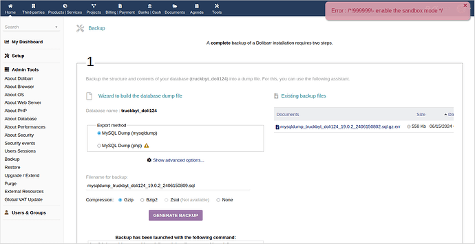

Backup Error .sql.gz.err
Each time I try to create a backup I get an error message and the backup file ends with “backup error .sql.gz.err”

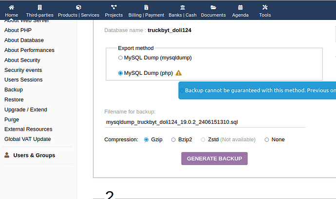

have you tried selecting this option?
“MySQL Dump (php)”
The error is in the red box in the top red, what is that text?
The full error is - Error : /*!999999- enable the sandbox mode */
The other format works but is not recommended
