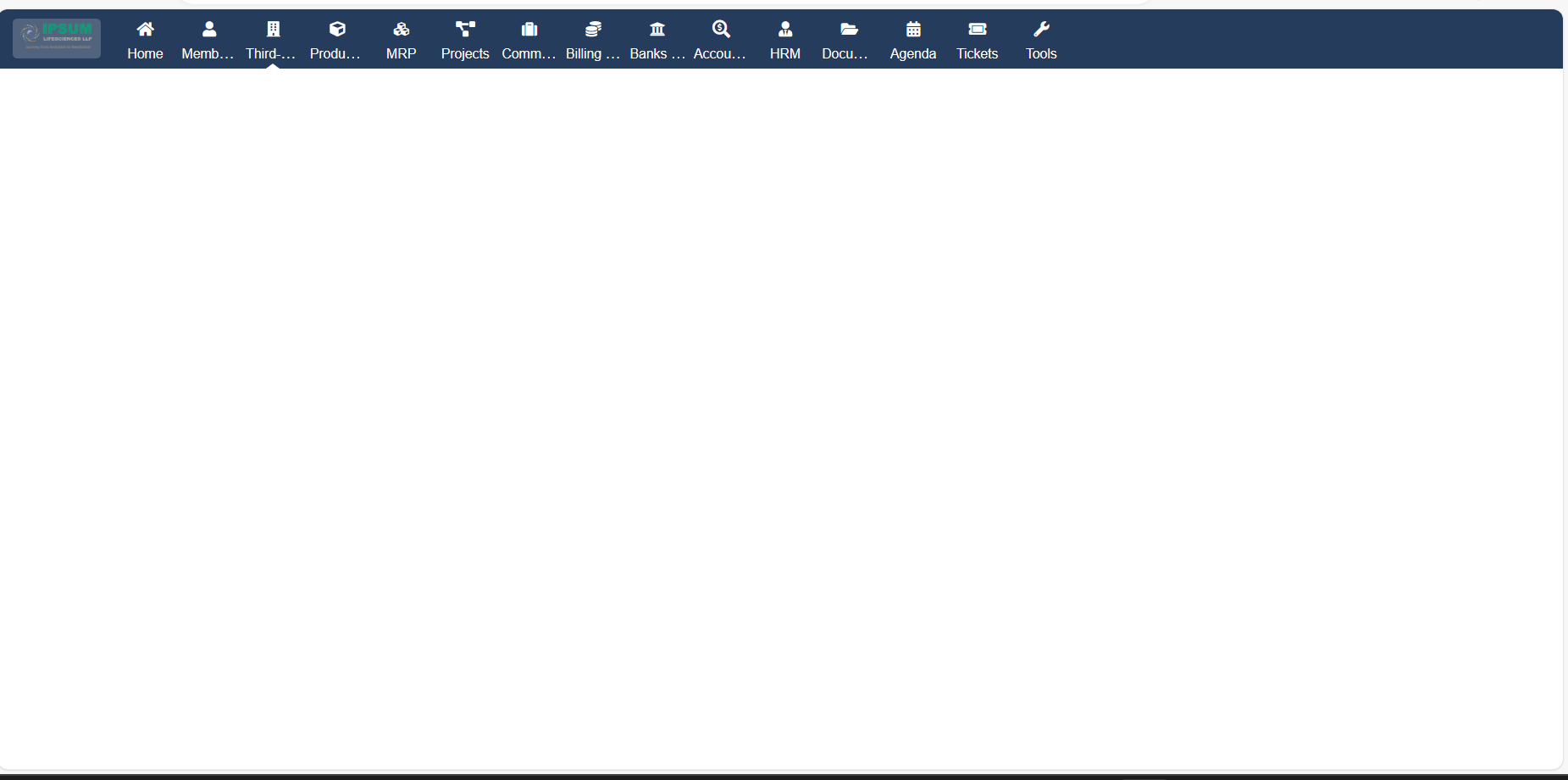

I am getting above blank screen upon login to my admin account. I am able to click on the menu Items, but nothing is opening.
However, on user accounts, things are working fine.
This just happened after I activated Advanced Module Builder Plugin downloded from dolistore.
Please support how to get things back.

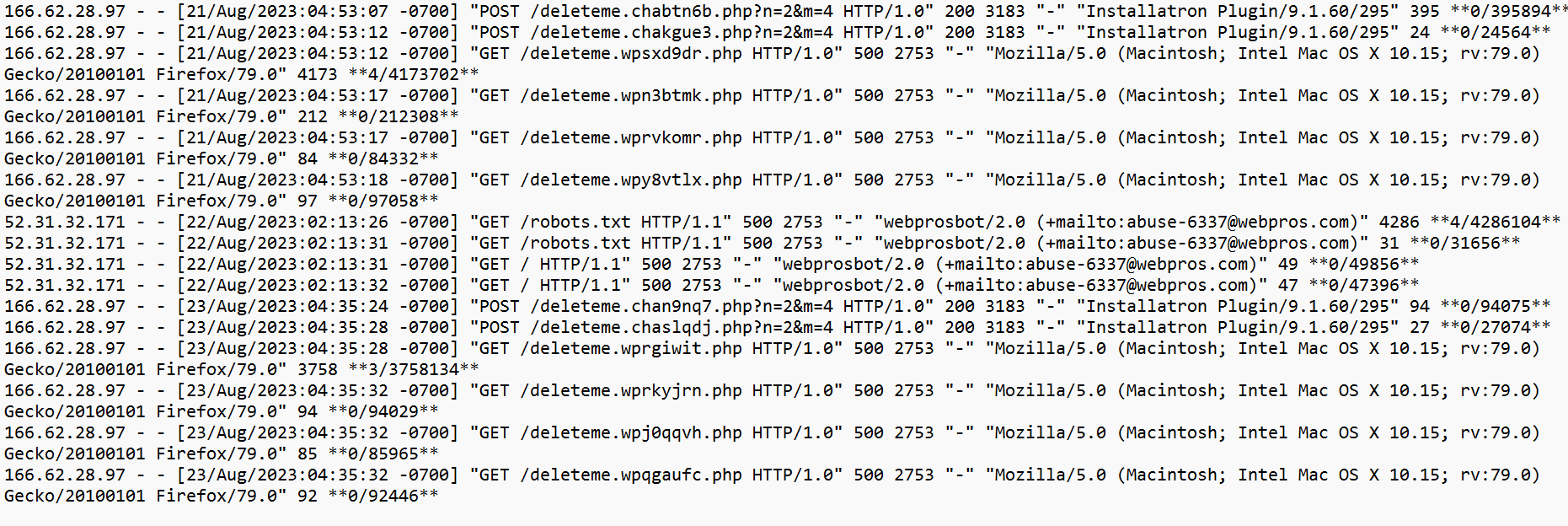

In Log file I am able to get below:
Infact I have activated that module (Module Builder Plugin) on 21st August, 2023.
Please guide what to do.
Best Regards,
This is the access log and not the error logs.
But if you have a look in your access logs, there is very strange script names : deleteme.xxxxx.php => Sounds like a hack !
And this part ?

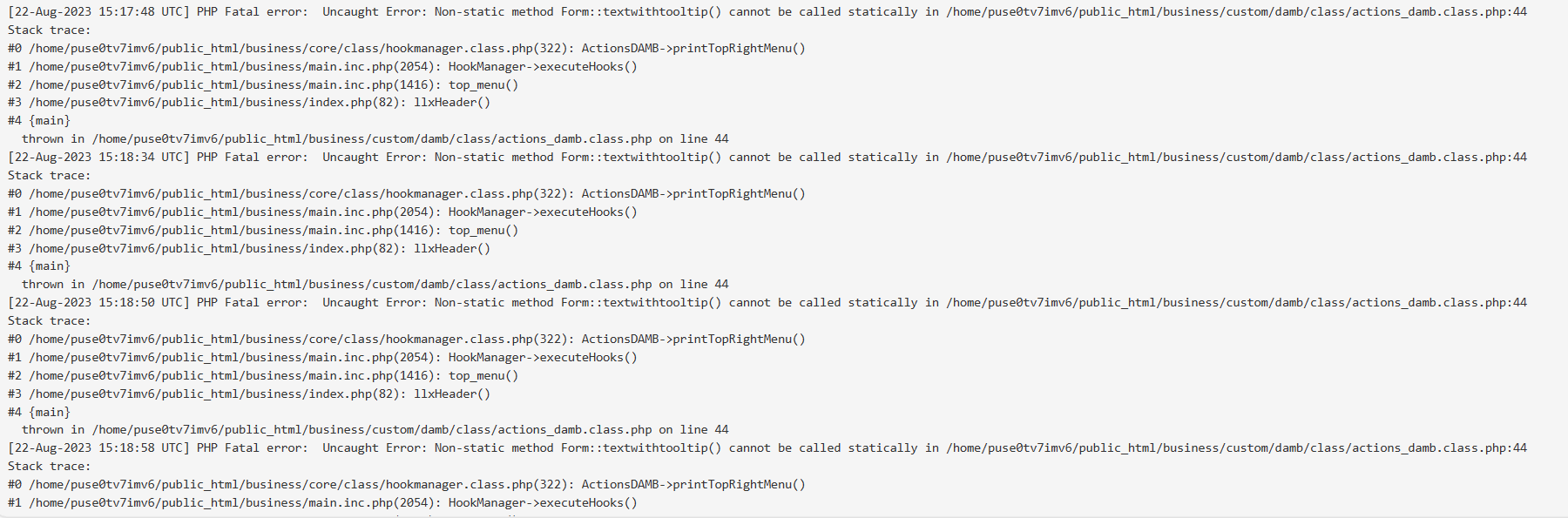

Error Log as per attached image.

as explained, you need to remove the dam directory on the custom directory
Remove the damb folder from the custom folder then check once.

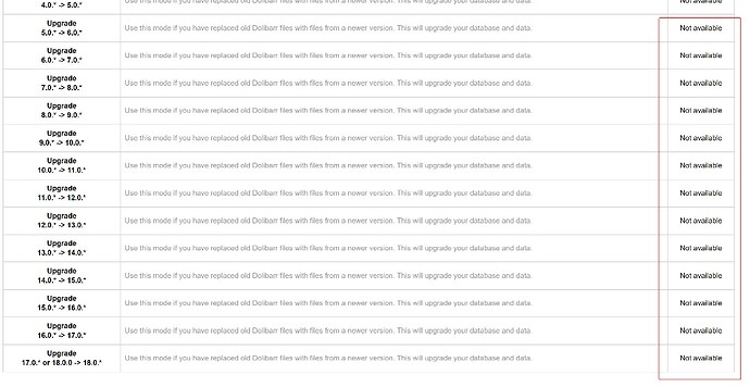

Upon upgrade i landed on several issues…
upgrade to version 18 did not allow me to proceed, i was getting an error , Not Available
Same Error on version 17 php files. so i went to version 15.
Again on version 15, i managed to upgrade however the upgrade screen could not exit, kept looping back and redirecting into upgrade (Install directory).

good. I think I would have upgraded 12->13, 13->14, 14->15, 15->16, 16->17, 17->18, 18->19
Yes I did upgrade step by step (12->13->14->15). it wouldn’t go above V15.
