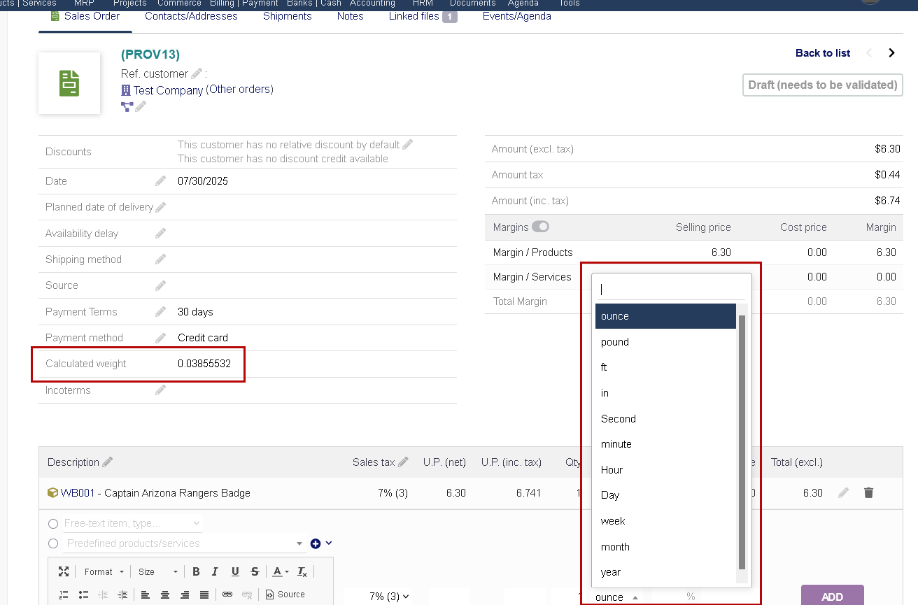

I’m new to Dolibarr and testing it. I’m having difficulty finding where the setting is for the Calculated weight on the sales order and shipments tab. It’s showing in grams but I need it to show in imperial measurements ounces or pounds. I’ve turned off all metric measurements in Dictionaries > Measuring Units but it still shows the weight in grams.

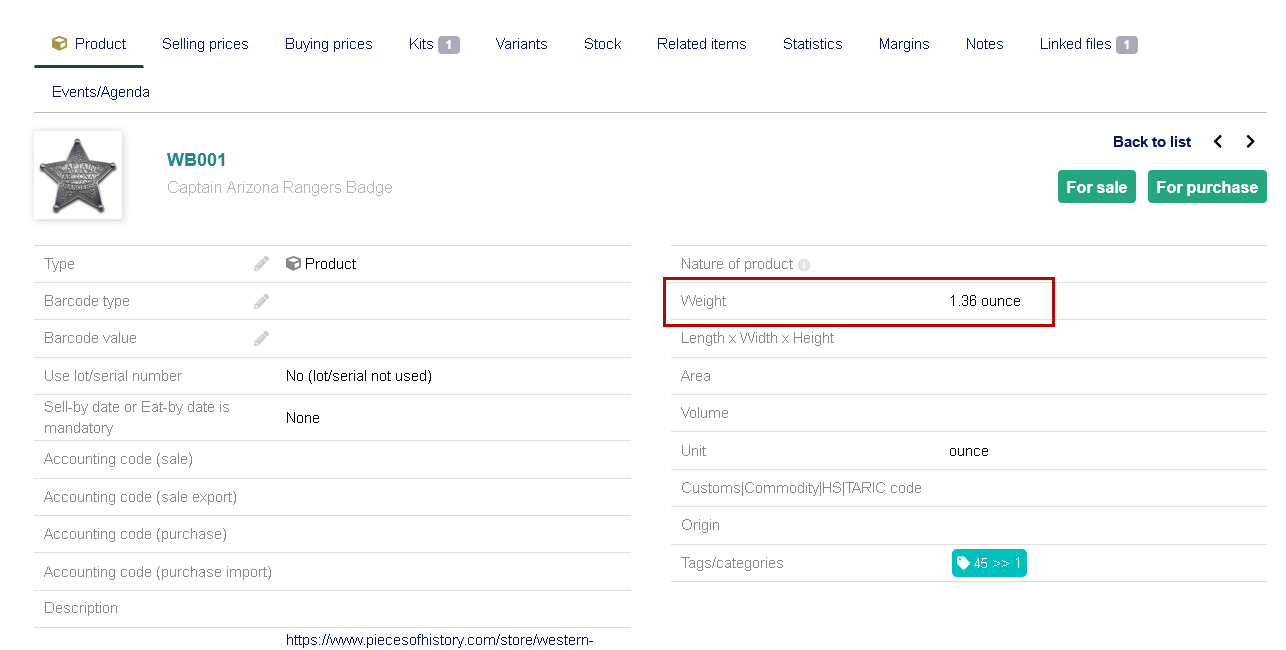

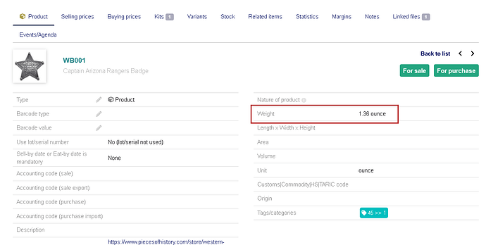

On each individual product, have you defined its weight in in “x” number of ounces/pounds?
I’m not sure if that is your problem but could be a contributor.
Hope that helps.
Frank
Thank you for the suggestion. Checked and the product weight is in ounces.

can you try to set “MAIN_WEIGHT_DEFAULT_UNIT” to 98 for ounces or to 99 for pounds
in “Setup” - “Other setup” function
Good continuation
Thank you for your suggestion. I tried it and it changes the weight to KG. I did an internet search with the new information and it looks like this has been a problem for a while. I found this fix but trying it just crashes the program - [BUG] MAIN_WEIGHT_DEFAULT_UNIT doesn't work for Ounce & Pound · Issue #10299 · Dolibarr/dolibarr · GitHub

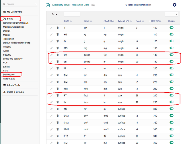

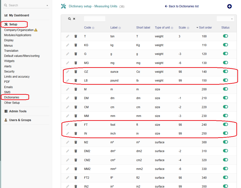

Lokk at Setup - Dictionaries - Measuring units :
Good continuation
@cindy which of your units are enabled?
Everything is turned off except - ounce, pound, foot, inch, and the date and time units.
This is the product setting:
