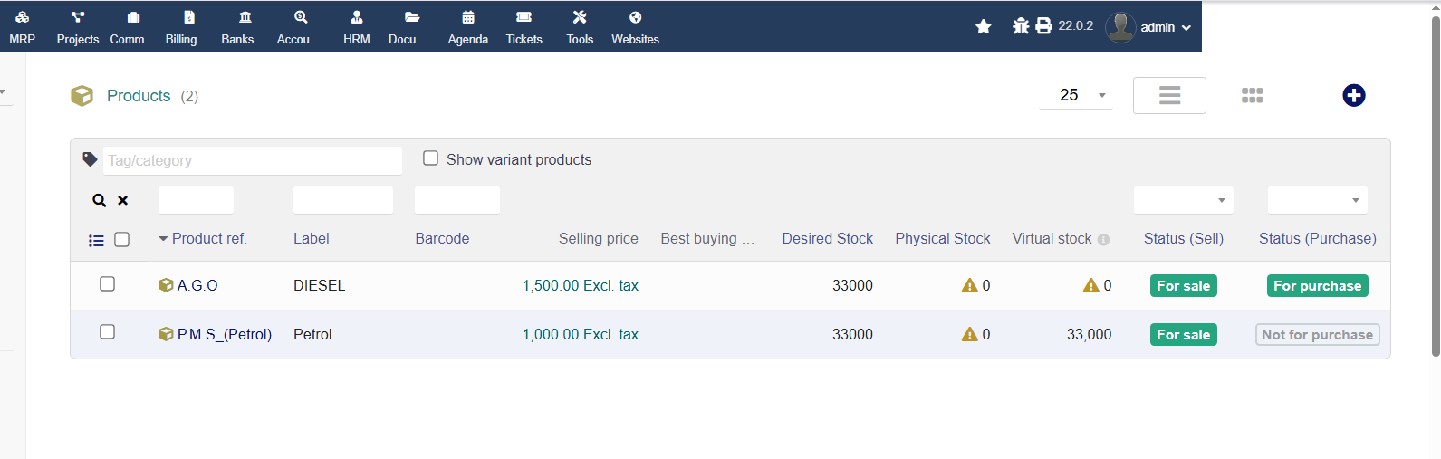

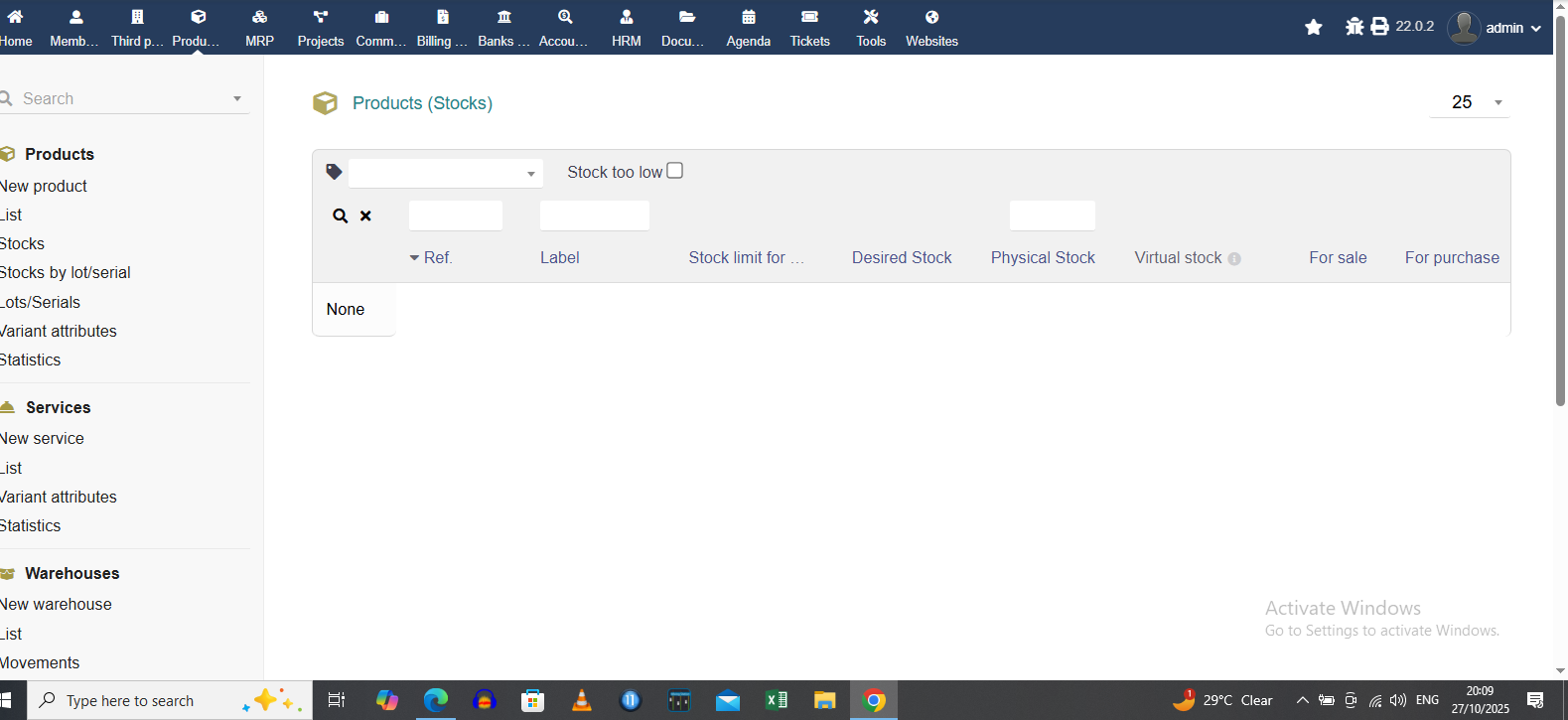

I am as well having issue with stock…after creating product I dont see where i can input physical stock. so therefore the product is not listing under stock.
Please find attched pictures for more clarity.
Did you enable the stock module in the configuration? (I don’t use that part of Dolibarr).

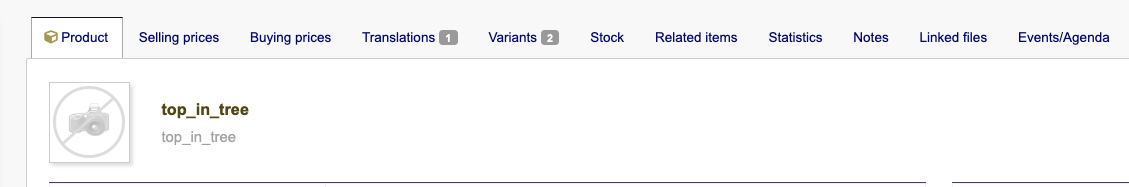

I think that you need to find one of your product, and then there is a Stock tab
Yeah, got it. many thanks bro. God bless you.
