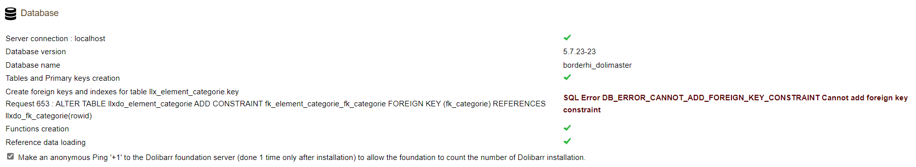

I got this error:
Create foreign keys and indexes for table llx_element_categorie.key
Request 653 : ALTER TABLE llxdo_element_categorie ADD CONSTRAINT fk_element_categorie_fk_categorie FOREIGN KEY (fk_categorie) REFERENCES llxdo_fk_categorie(rowid) SQL Error DB_ERROR_CANNOT_ADD_FOREIGN_KEY_CONSTRAINT Cannot add foreign key constraint

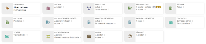

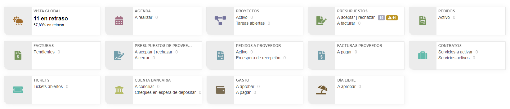

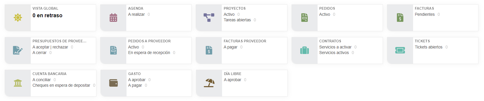

Just went manually over that script and created a new one that reverts all of the changes from that file and looks like it worked ok, the only thing is that when I updated to Dolibarr v16 the top dashboard info is missing, I am not sure this can be repaired since some of the data was deleted when the DB was updated to v17 and I don’t know exactly what table is the one with that data, please let me know if this can be fixed (attached an image from the before and after of the missing data).
