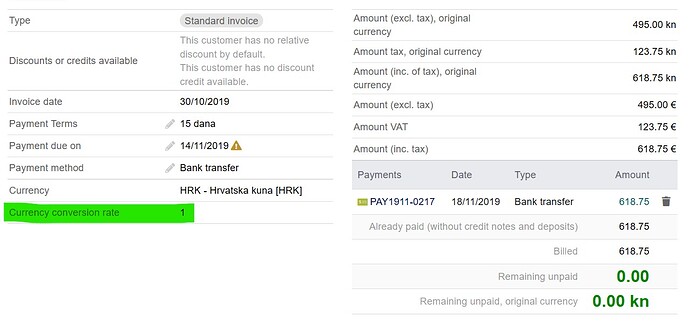

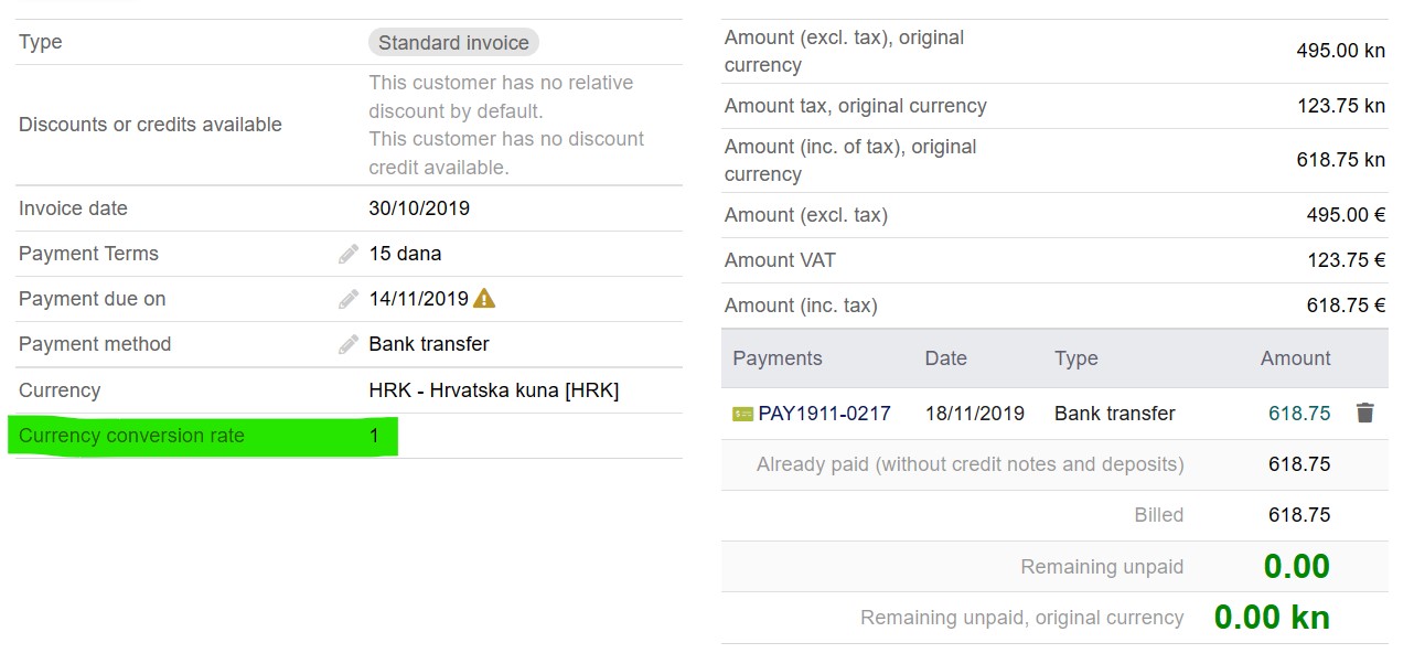

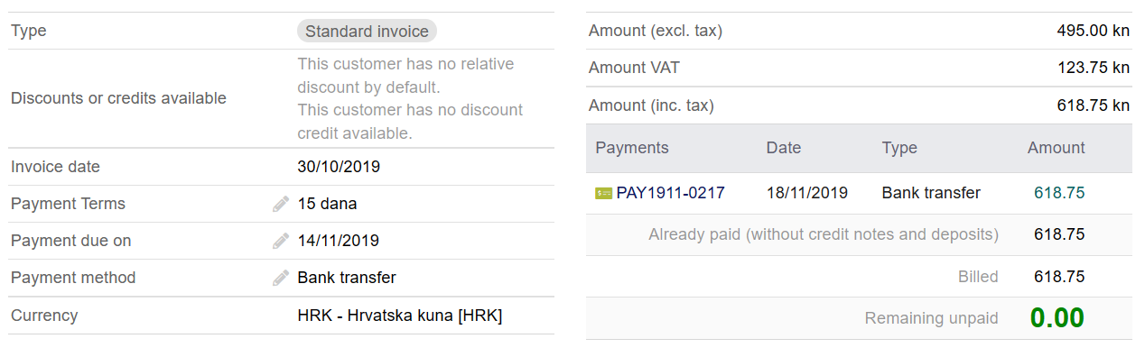

This is the same invoice when default currency is changed from “kuna” to “euro”.
The amounts are the same. Currency conversion rate is “1” although I’ve entered the correct exchange rate “0,13” in multi-currency modul setup.
This is a bug since v. 16. In 15 and earlier versions works correct. I am waiting for solution too.
