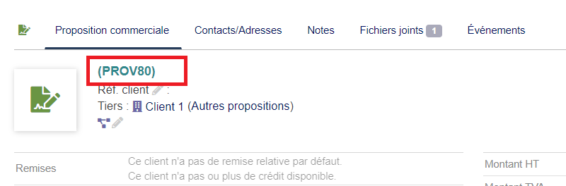

Good morning,
I have been using Dolibarr for 6 months and I have to enter old quotes and invoices with their number.
S I have to manually enter the quote number.
I see that there is the possibility to manually modify the invoice number (activating INVOICE_ALLOW_FREE_REF) but there is no way to change the quote number.
Is there a way to do this?
Thanks for your support!

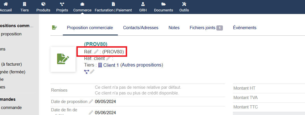

I made some changes to the code.
In the htdocs\comm\propal\card.php file I added this code:
// Ref proposal
$morehtmlref .= $form->editfieldkey(“Ref”, ‹ref›, $object->ref, $object, $usercancreate, ‹string›, ‹›, 0, 1);
$morehtmlref .= $form->editfieldval(“Ref”, ‹ ref ›, $object->ref, $object, $usercancreate, ‹ string ›, ‹ ›, null, null, ‹ ›, 1);
$morehtmlref .= ‹
So I was able to have the link to modify the quote number
However I received an error when I tried to modify the number.
Any idea?

It’s true that I was able to display the link which allows me to modify the proposal number, however if i change the number and validate I receive an error “Record not found”
I’m still looking for the solution.
I’m still looking for the piece of code that allows the update on the database.
If some can help.
