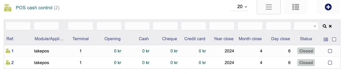

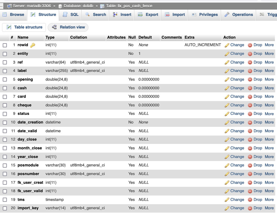

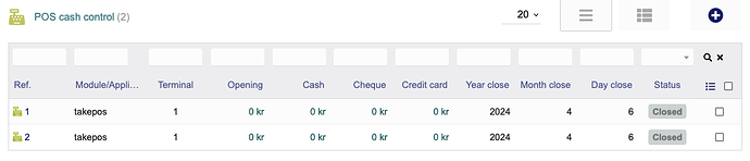

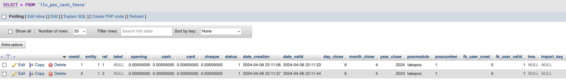

Here’s some database content from 2 test I did
We need to add this ref to invoice to be collected in the cash report
