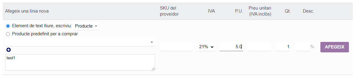

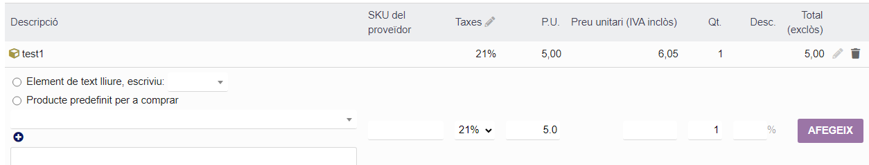

For example, I’m creating an order for a random supply with a price of 5.0€:
Here the correct result:

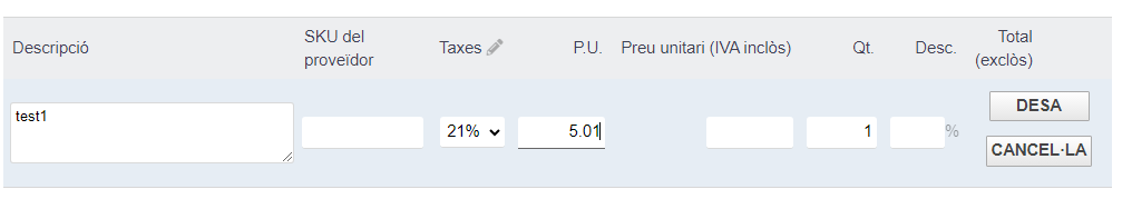

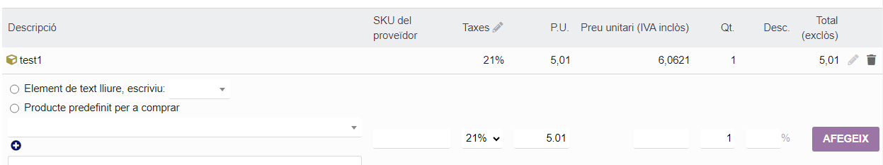

Now the same with a value of 5.01:
The result is correct, too:

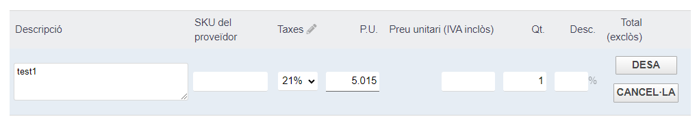

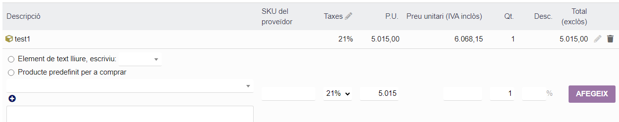

And now the price with problem: 5.015:
This is the incorrect result:

You should use , not . that’s all
If you know that your location settings indicate to use “,” for decimal, why are you using “.” to capture prices ¿?
I suppose that the annoying thing for you is that Dolibarr “understand well” when you write “5.01”, but in fact you should write “5,01” :sweat_smile:

Yes because . is declared as thousand separator.
You could try to declare ; as thousand spearator to see if it is better.

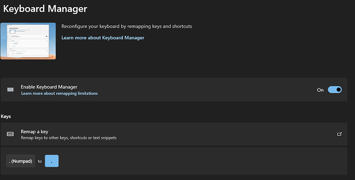

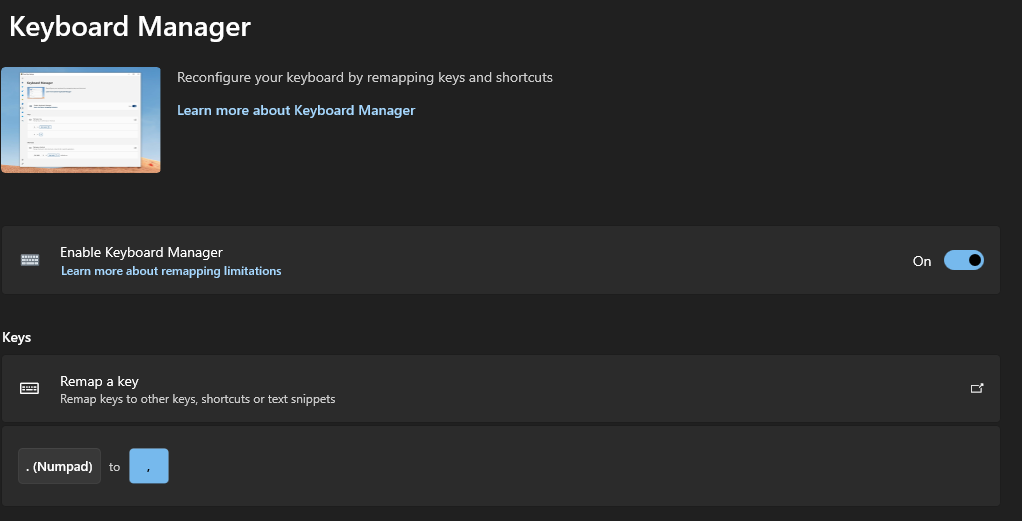

In this case, I solved the problem by using the Microsoft PowerToys programme to set the dot on the numeric keypad to a coma.
https://github.com/microsoft/PowerToys
