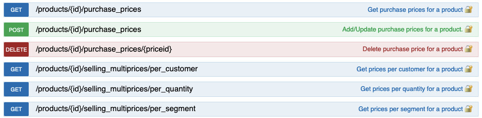

Difficulty Finding API Route to Set Customer-Specific Pricing in Dolibarr
I’ve been tasked with setting customer-specific pricing through the Dolibarr API. However, after thorough exploration, I’ve found that while there is a GET method available to retrieve pricing information that has been manually added through the Dolibarr interface (GET /products/{id}/selling_multiprices/per_customer ), I haven’t been able to locate a corresponding API route to set or update this pricing programmatically.
This limitation has hindered my progress in automating the pricing management process, as I need to dynamically adjust pricing based on customer profiles and other factors.
I’ve checked the Dolibarr documentation and conducted online searches, but unfortunately, I haven’t been able to find a solution to this issue.
I would greatly appreciate any guidance or assistance you can provide in resolving this matter. If you have a moment to discuss further or provide any pointers, please let me know at your earliest convenience.
@Souhail yeah that seems true that the API even in the develop branch can only get that price.

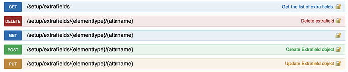

I recently expanded API functionality and it is not complicated.
I am not using multipricing, so I don’t know if it is available inside the Dolibarr GUI, but if it is available, then surely there are already functions that can do that and you basically only need to get the API to use them. That is what I did for a lot of my extensions. Like when I wanted to extend the API setup extrafields which also only existed in GET I found and reused functions that the Dolibarr GUI already used.
