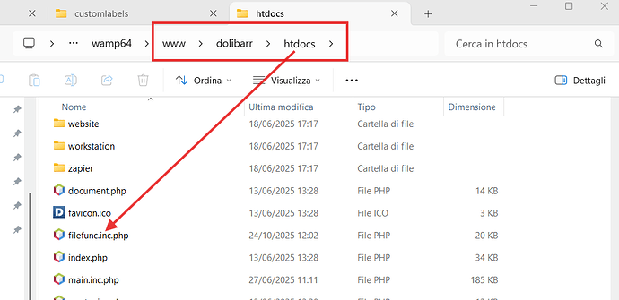

Is that a special module you have installed? Because I do not have any path like that in my (dev) Dolibarr (develop branch) (the version at hand I could just easily test)
I have this file in the htdocs folder

Correct, I have that file as well @mgribaudo but, that is not the file mentioned in the warning message you posted.
