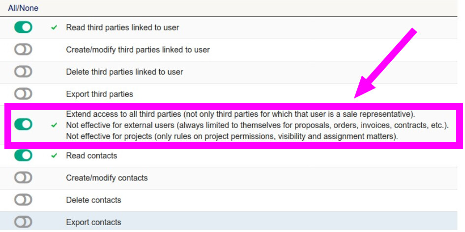

Did you set the proper user permissions?
If you enable to “Extend access to all third parties”, any user will be able to see “all third parties”.
Hi, thanks for your reply!
Yes, I double-checked that setting.
The option “Extend access to all third parties” is not enabled, and the permissions are set correctly.
In fact, users cannot open third parties that are not assigned to them — they get a “Permission denied” error, which is expected.
The issue happens only in the “List” view (left sidebar) using the Eldy menu: it displays all third parties, even though the user can’t access them.
So it seems the list view doesn’t filter based on user permissions, but the individual record view does.
Thanks again for your input — any other ideas are welcome!
