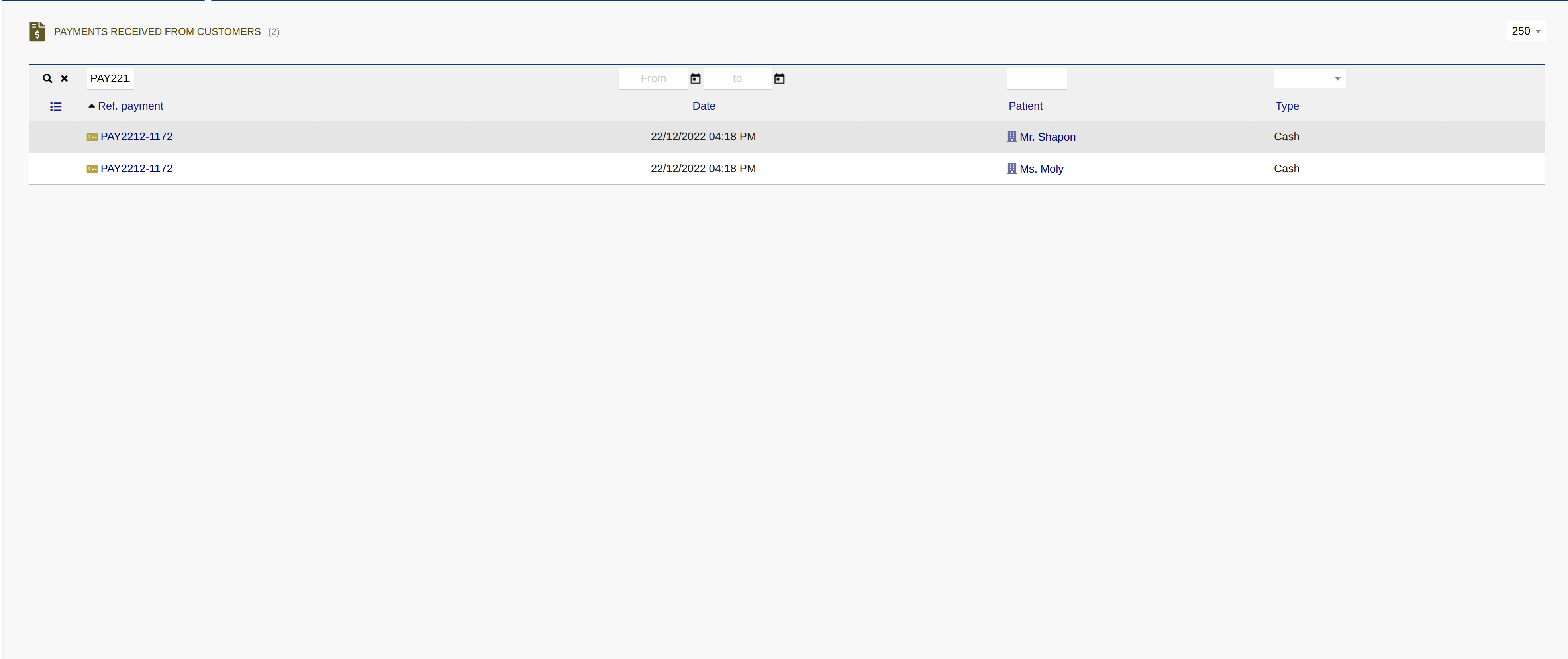

I am encountering an issue where duplicate values are generated in the ref field of the llx_paiement (Payment) table.

When creating payments, the ref value is occasionally duplicated. The issue appears to be related to very short time gaps between payment creations.

  • Duplicate ref values detected
  • The issue occurs when two payments are created within a very short time interval (≈1 second or less)
  • This suggests a possible race condition in reference generation
  • The ref column does not have a UNIQUE constraint at the database level

We receive payments by multiple reception at a time from different booth.
The same payment reference has been used for two different patients.
