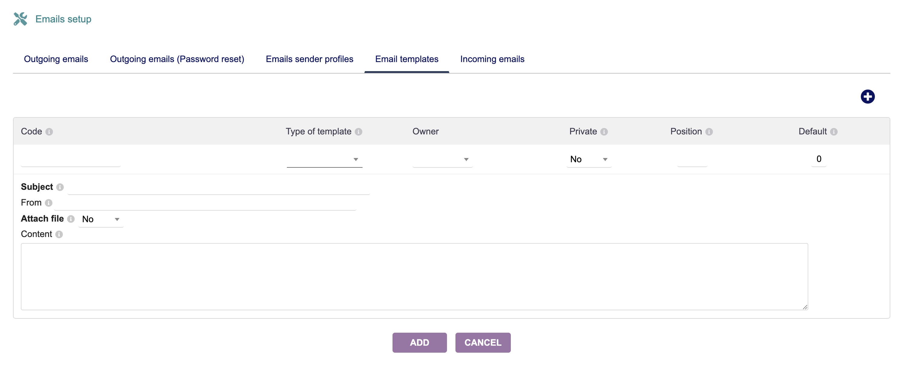

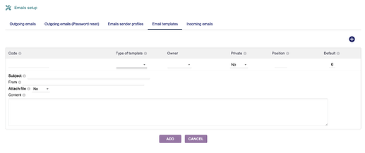

Step 2: In the same area of Emails setup choose tab> Email Templates
Click the + sign. This screen will appear:
Now you can create up to a few different types of templates here. I have 3: 1 template for when a customer invoice is Validated, another for when it’s changed to Paid, another for a cancelled invoice, each with different subjects, and content, so you can see the notification at a glance.
