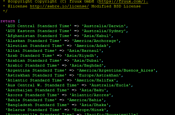

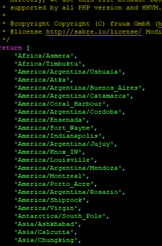

I made the modifications of the two files to “America/Argentina/Buenos_Aires”, then I did a new installation. But I get the same error… Where does the value “America/Buenos_Aires” come from?
Add a new issue.
Did you make the changes locally or did you edit them on github and made a merge reuest?
Are your changes still in the new installation?
I made the changes locally in those 2 files before installing. But the same error continues. On github just add the issue
Are the changes still there after the install or was they overwritten?
Yes, they are still there, they were not overwritten

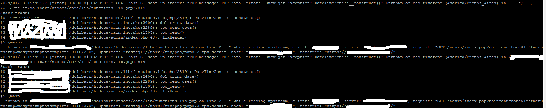

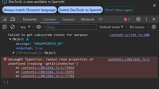

Okay. Are there any errors in your browsers console? (you might need to go into developer tools in your browser).
What does the Dolibarr hosting log say? what does your webserver log say?
Chrome:
chrome-error
Nginx error:
dolibarr/htdocs/includes/sabre/sabre/vobject/lib/timezonedata/php-bc.php (modified before installing)
php-bc
dolibarr/htdocs/includes/sabre/sabre/vobject/lib/timezonedata/windowszones.php (modified before installing)
windowszones
nginx says that it is still looking for America/Buenos_Aires, so I’d like you to check these 3 things and do a 4th things.

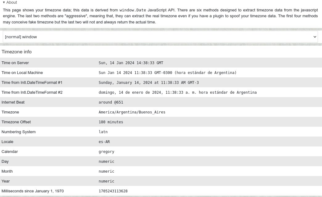

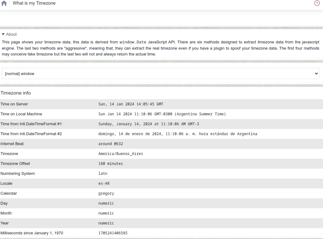

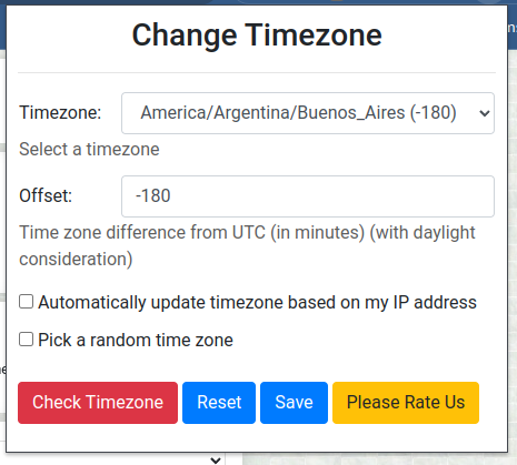

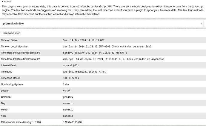

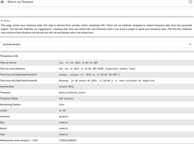

I think I found the error: It’s the browser. I don’t know why it has that wrong value for Buenos_Aires. I installed a plugin where I can change the time zone in Chrome (natively you can’t). I change the time zone as you can see:
Zona1
But when checking (Chrome, Brave, Edge, Chromium)
The zone is bad.
Mozila Firefox:
The zone is good
The question is. Is it possible for Dolibarr to take the timezone of the web server (nginx, php) Not the browser?
Thank you very much
Luis
