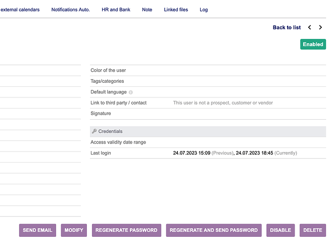

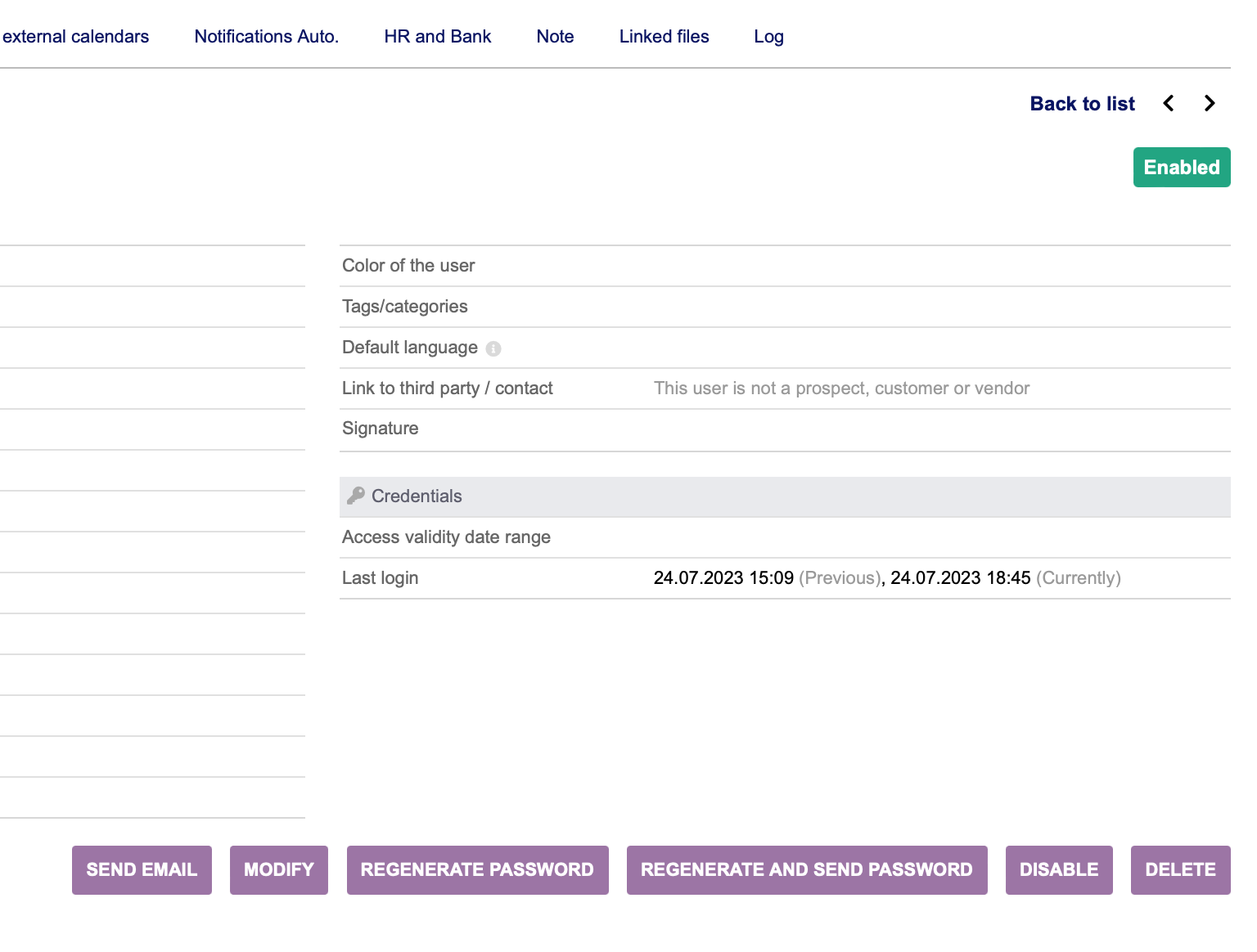

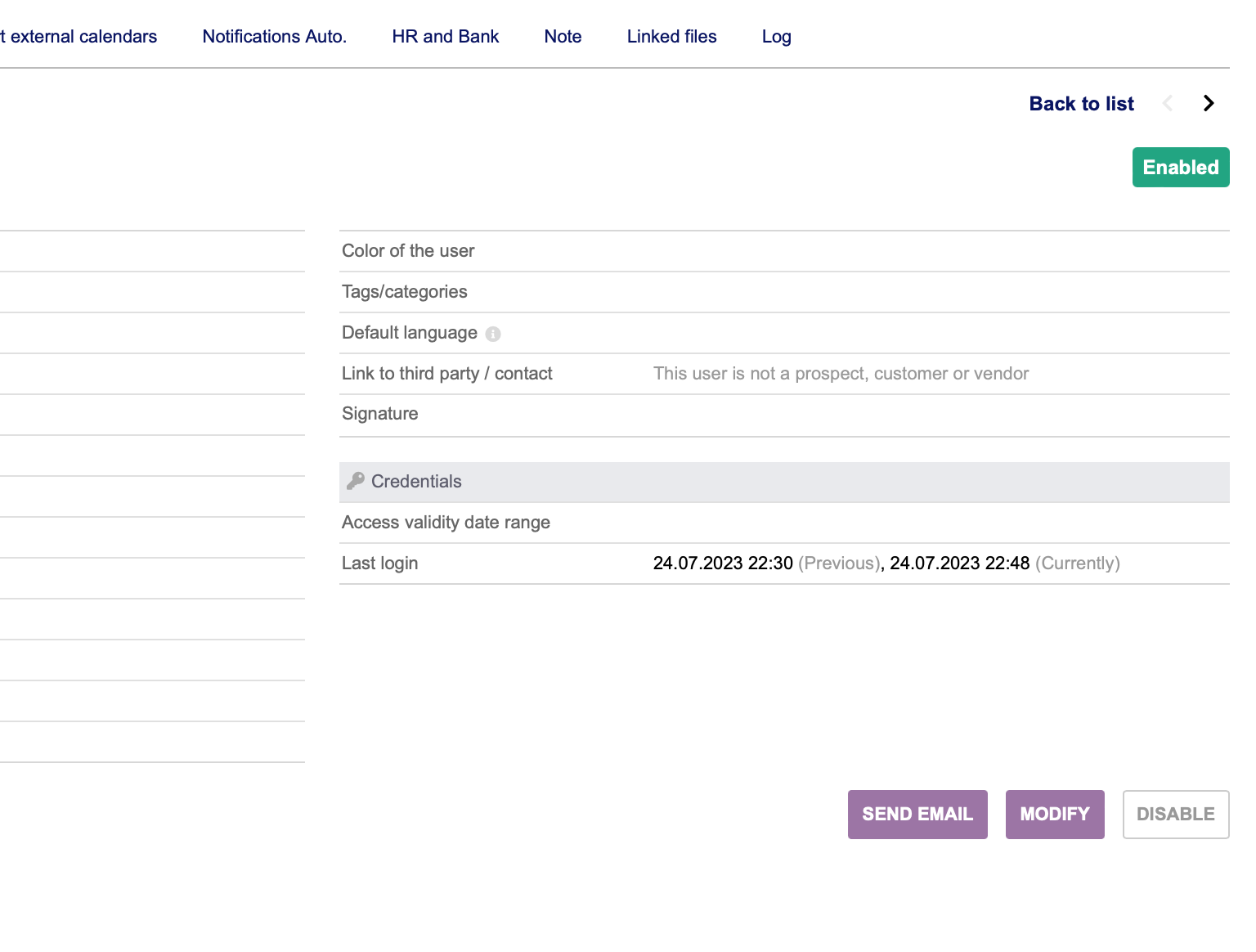

Hello Again
i have several dolibarr installations one of them no show regenerate user password for users even after upgrading to latest version, i attached 2 screed shot for difference between 2 installations
could you help?
Thanks

no both users are admin you may noticed that delete is not active for the first because its the account used to login so cannot delete, dont worry about that
the problem in regenerate password and regenerate and send password both bottoms not visible at all to any admin
its very strange

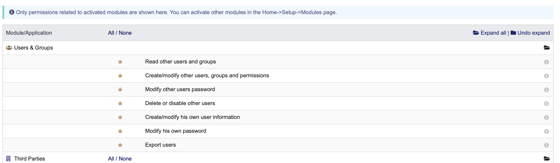

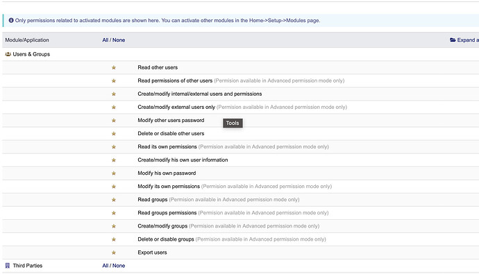

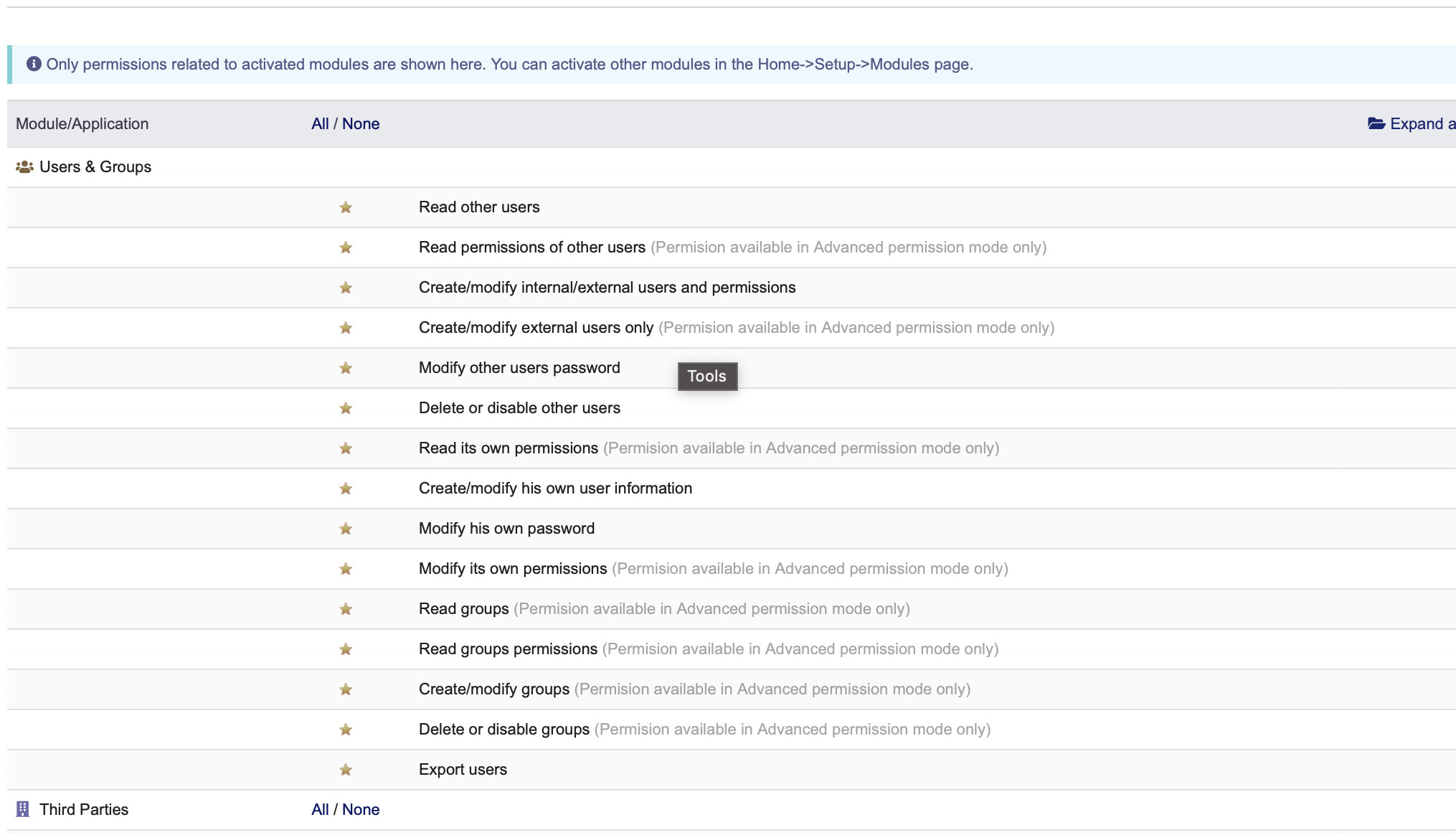

@Absmachin
you will notice in attached that in the installation having this problem you can read advanced permission and in the other good one less lines and there is no advanced permission
module advanced permission i bought it from dolistore but i found it case some wrong permissions so i disabled it and delete it, when i find out that there is no regenerate password installed advanced permission module again but nothing changed.
i need the reset permissions to not show advanced permission but dont know how
