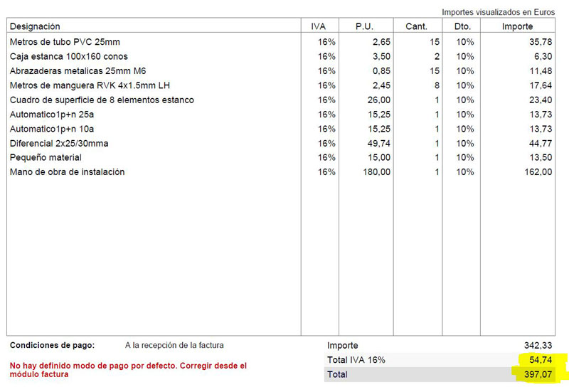

As you can see at the attachted invoice i m sending, with 16% VAT and 10% discount, at the end the total calculation comes with 3 cents less.
for instance:
342.33 + (16%)54.74 = 397.07 —> invoice dolibarr calculation
342.33 + (16%)54.77 = 397.10 —> invoice my onw calculator
i ´ve noticed the more lines i have in the invoice, the biger is the mistake.

I made also a simulation of the same invoice in excel, and the result of the VAT is not the same as Dolibarr.
Dolibarr: 54.74
Excel: 54.77

When you use excel you ask to round the sum of each invoice line.
When you use dolibarr, you ask to sum the rounding of each invoice line.
2 different way of rounding and two different results. Both solution can be user to make accounting but solution used by dolibarr is easy to use when you need to dispatch vat when vat rate differs.
