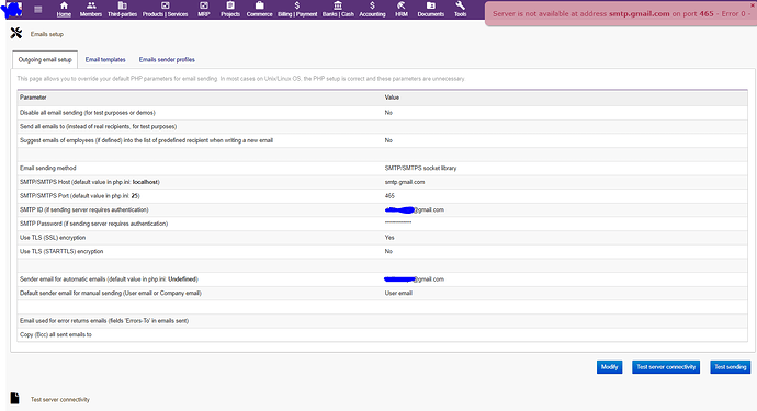

could you print screen the configuration ?
https://wiki.dolibarr.org/index.php?title=Setup_EMails#Gmail_.28with_login.2Fpass_or_login.2Fpass_of_application.29
All settings are as per the manual.

I saw the setting is fine. But the sender and receiver are same email address. Maybe smtp google refused it. Can you try again with different receiver email?
No I tried with other receiver addresses too

I’m not experienced with coupling Dolibarr and gmail, but my configuration
has “TLS (STARTTLS) encryption” activated instead of “TLS (SSL) encryption” in your case.
Furthermore my SMTP/SMTPS Port is set to 587 which refers to the encrypted version of SMTPSecure.
This is of course in accordance with my personal webspace and email hoster, so google may demand other settings.
