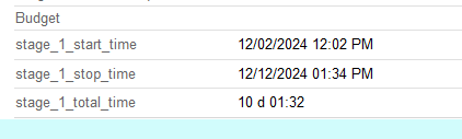

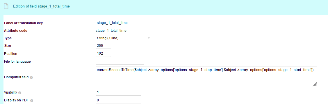

I have a problem with writing a Trigger. I want the trigger to calculate the time elapsed between the date and time in field 1 and the date and time in field 2. I created three fields in the Dolibarr Task module: stage_1_start_time (Type Date and time), stage_1_stop_time (Type Date and time), and stage_1_total_time (Type String 1 line). I created a trigger named interface_99_all_CalculateTaskTotalTime.class.php and placed it in the htdocs/core/triggers folder. Unfortunately, the trigger code does not calculate the time (or does not save it correctly), and I do not understand why. I do not fully understand how triggers work, and the documentation does not explain it clearly for me (Triggers system - Dolibarr ERP CRM Wiki). Dolibarr, for example, creates a table with names like options_stage_1_start_time, options_stage_1_stop_time… and places the date and time in the timestamp format, while my fields in the database save data in the date and time format. I am not sure whether to perform operations on the data from the database (Date and time) or the data from the Array (timestamp). The trigger appears correctly in Admin Tools → Triggers. One more question: If instead of -all_ I would like to name the trigger with the module name, should I name it interface_99_modProjet_CalculateTaskTotalTime.class.php (since Task is part of the Projet module), or interface_99_modTask_CalculateTaskTotalTime.class.php? My code: <?php class InterfaceCalculateTaskTotalTime extends DolibarrTriggers
