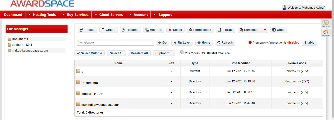

Hi
i have transfer files through filezilla file client and me noteiced 3 unsuccessfull file transfer
when me try yo loggin dollibarr is not activated.
pls see message me recived from Awardspace.com
Please note that you have successfully uploaded your files. Unfortunately there are no valid files which you can access to install your website. Please contact the developers of your application for further assistance.
kindly assist me with hosting issue

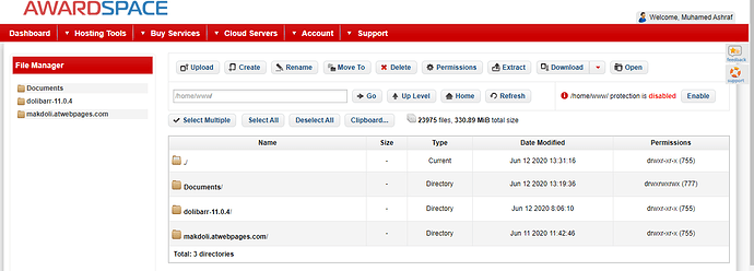

Could you go throught the process you went through for uploading? Would you be ok sharing your Domain name also?
Thank you
zip Files downloded from sourceforge
extracted
using filezilla client file transfered
but when me tries to acces on web me fails

You need to upload only the htdocs folder of the archive.

I was just about to say the same. and will then need to follow the correct path
pls check these are the files ???

Yes,
After upload you will be able to launch the installation by browsing the folder with your web browser

That is correct Copy this folder accross then follow the path

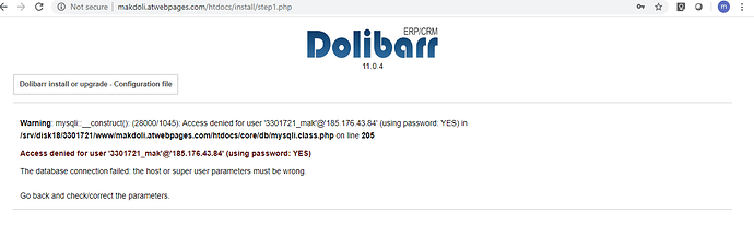

at last me success to host my Dolibar see next problem me facing
kindly lead me
ksar
June 13, 2020, 12:17pm
12
HI,
Check the connexion to the database in the file conf/conf.php

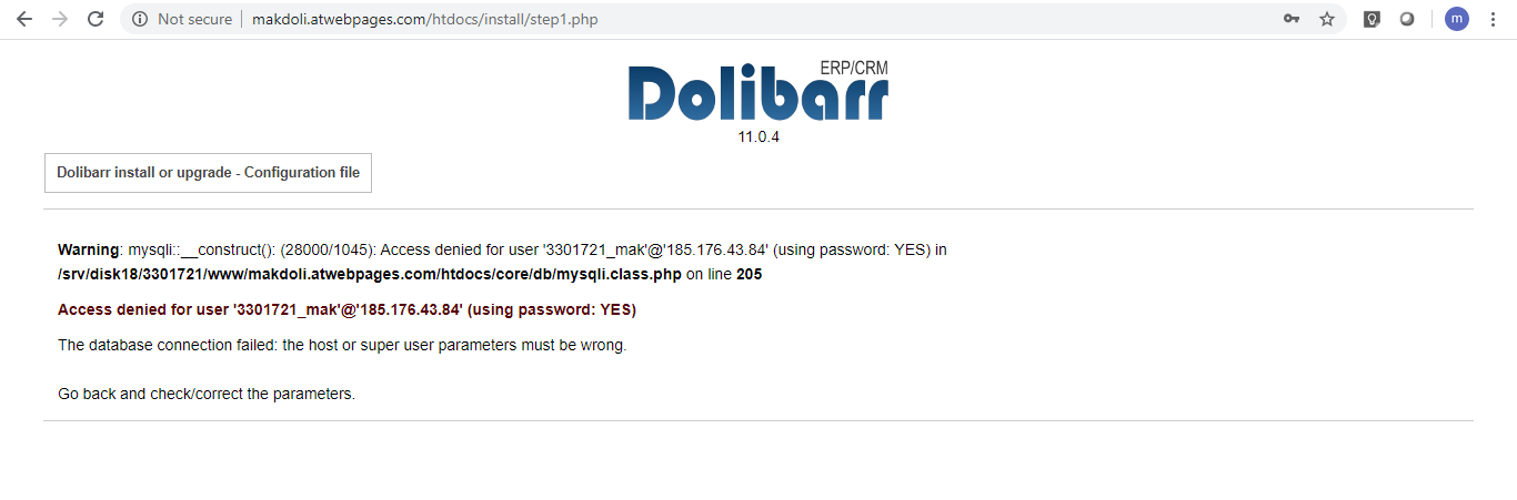

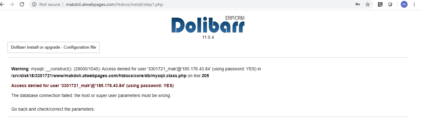

hi pls see how to solve this issue
kindly guide me

Access Denied = Wrong User or Wrong password

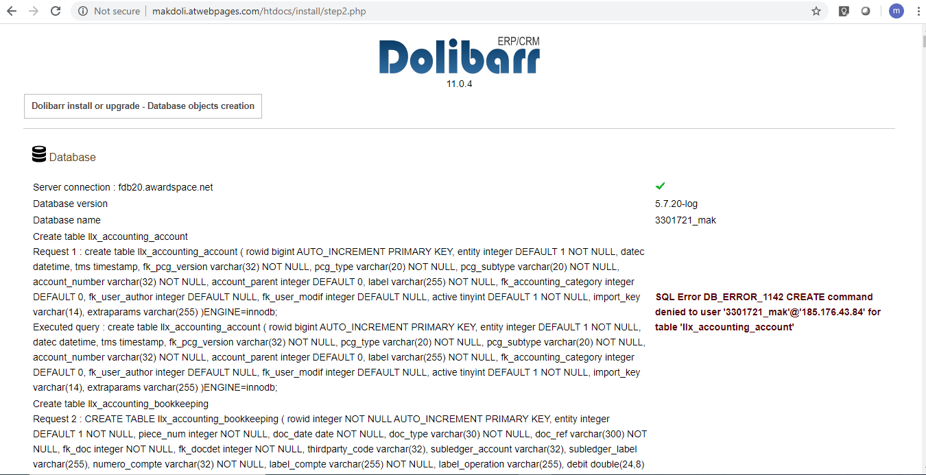

Hi ksar
enterd to step 2 ., now see the new issues
pls see attached.

Create is denied for your MYSQL user.
Check the rights of the user.
