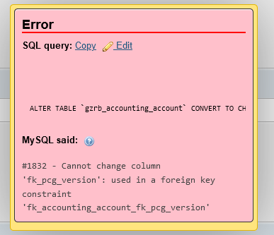

I succeeded to change all table in phpmyadmin apart from the “gzrb_accounting_account” which had the error message:
FireShot Capture 273 - auth-db1054.hstgr.io _ 127.0.0.1 _ u836212010_bTlg0 - phpMyAdmin 5.2._ - auth-db1054.hstgr.io
Is it possible to change “gzrb_accounting_account” to utf8mb3_unicode_ci ?
It is now utf8mb4_inicode_ci while all other tables are utf8mb3_unicode_ci.
I’m not a specialist on this type of issue, but if think you can leave like that for the moment.
