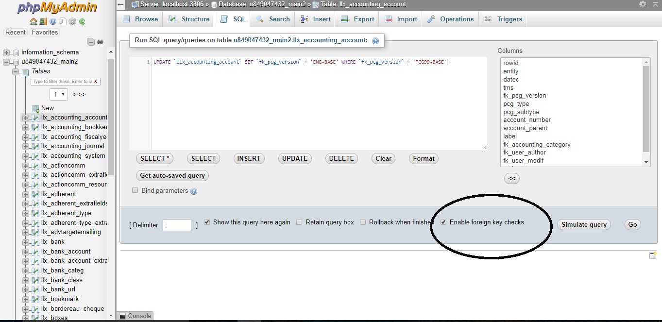

I am having issues here,
In phpMyAdmin version 4.3.8, I see no (Uncheck -> ‘Enable foreign key checks’) way or button.
I tried to run (SET FOREIGN_KEY_CHECKS = 0;) this seem to run ok, but when I try to run the (UPDATE llx_accounting_account SET fk_pcg_version = ‘ENG-BASE’ WHERE fk_pcg_version = ‘PCG99-BASE’) I still get the (#1452 - Cannot add or update a child row: a foreign key constraint fails)
It looks like WHERE fk_pcg_version = ‘PCG99-BASE’
Matched rows: 343
How do I get around this and update these rows?
Hi Alvin,
I hope you are using my revised tutorial which is here: English COA
See attached screenshot to locate enable foreign key checks:
You have to untick Enable foreign key checks.
