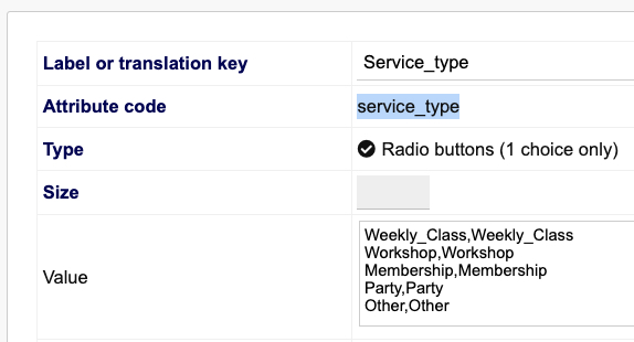

Screenshot of definition of an Complementary attribute
So as you can see I have one defined which I call service_type and which values I allow it to have.
