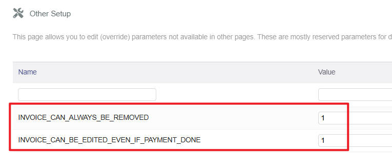

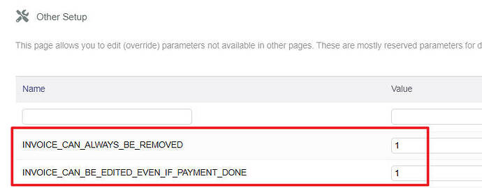

I need to allow the editing and deletion of invoices. The following two options are set in Other Setup
INVOICE_CAN_ALWAYS_BE_REMOVED
INVOICE_CAN_BE_EDITED_EVEN_IF_PAYMENT_DONE
Why is there no effect at all? Was there a mistake in the Settings somewhere?

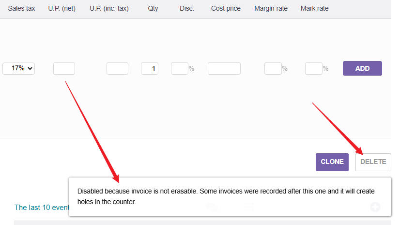

I have a lot of empty and invalid invoices now. There is nothing in them. I want to delete them, but I can’t

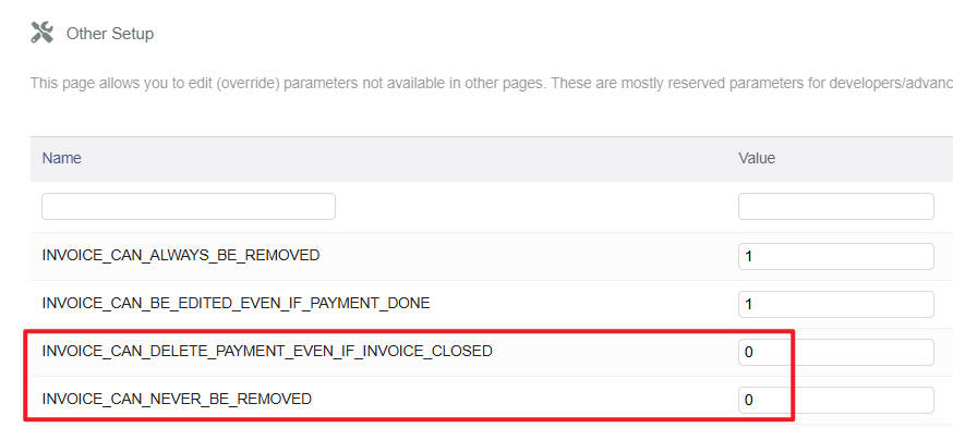

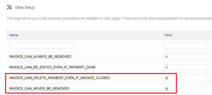

@TuHao here’s what I did
I got the dolibarr git cloned to my mac laptop, and then I used grep in the terminal to find all lines with INVOICE_CAN_
And I found that it seems like at least in the develop branch, the setting you need to use is INVOICE_CAN_NEVER_BE_REMOVED and the value should be 0 to remove the invoice.
If you invoices have payments, you might want to use INVOICE_CAN_DELETE_PAYMENT_EVEN_IF_INVOICE_CLOSED

Hello, I have filled in both of these items, but it still hasn’t had any effect. I still can’t delete the invoice

Hi @TuHao — this is a two-part problem in v23 that catches a lot of people: the constants AND the permissions both need to line up.
Step 1 — Check user permissions first
Go to Home > Users & Groups > [your user] > Permissions > Invoices. There are separate permissions for deleting draft invoices and deleting validated invoices. Even with the right constants set, if “Delete” isn’t explicitly checked for validated invoices the button stays greyed out.
Step 2 — The right constants in v23
In Home > Setup > Other setup, set:
  • INVOICE_CAN_ALWAYS_BE_REMOVED = 1
  • Make sure INVOICE_CAN_NEVER_BE_REMOVED is not set (or explicitly 0)
No server restart needed — takes effect on next page load.
Step 3 — Invoice status matters
A validated (status = 1) invoice with no payment can be cancelled back to draft first (Actions > Cancel), then deleted as a draft. That path always works regardless of constants.
For your empty/invalid invoices specifically: if they have no lines and no payments, cancel → delete is the cleanest route and avoids any database surgery.
Let me know which step resolves it — happy to dig further if the permissions check doesn’t fix it.
